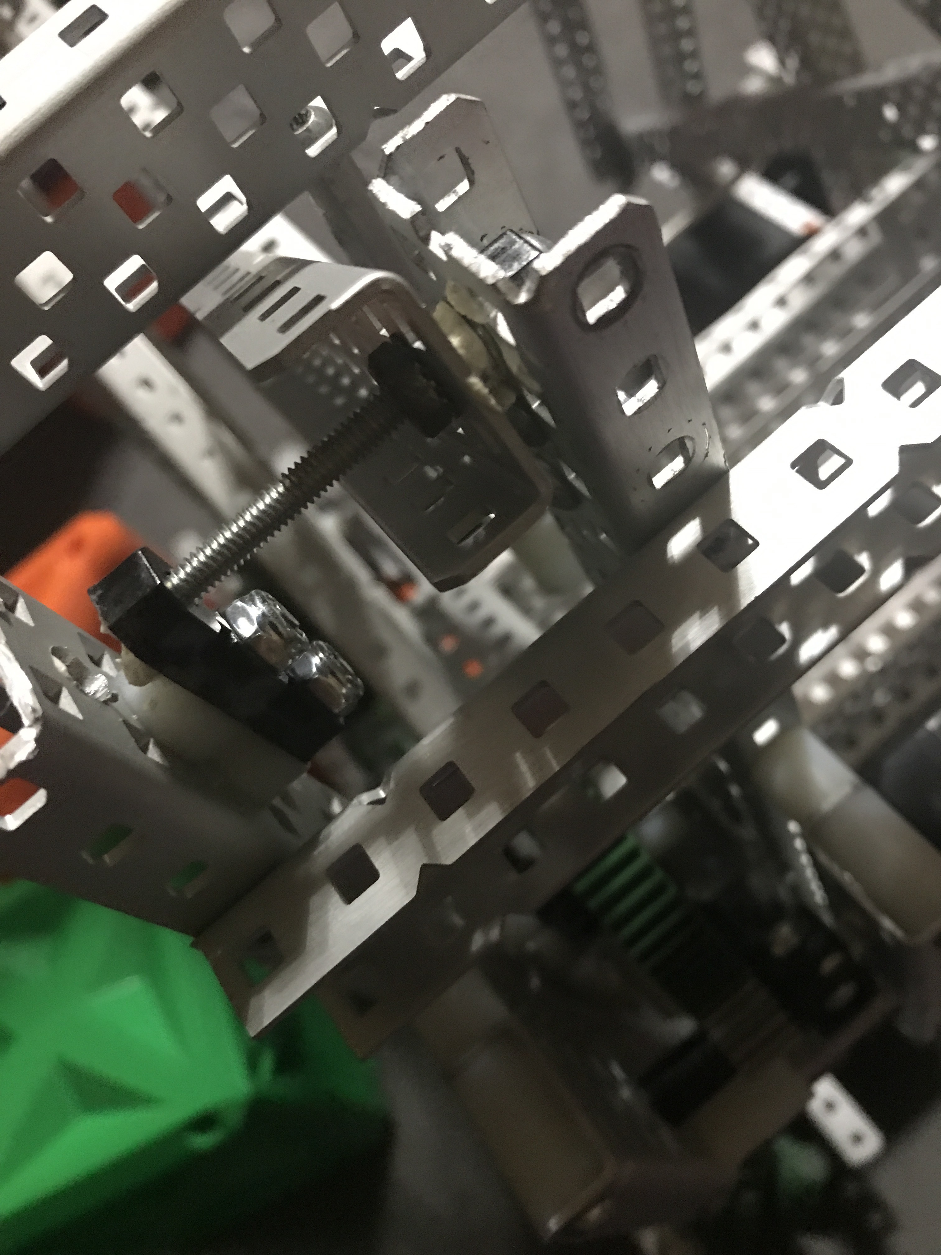

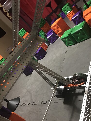

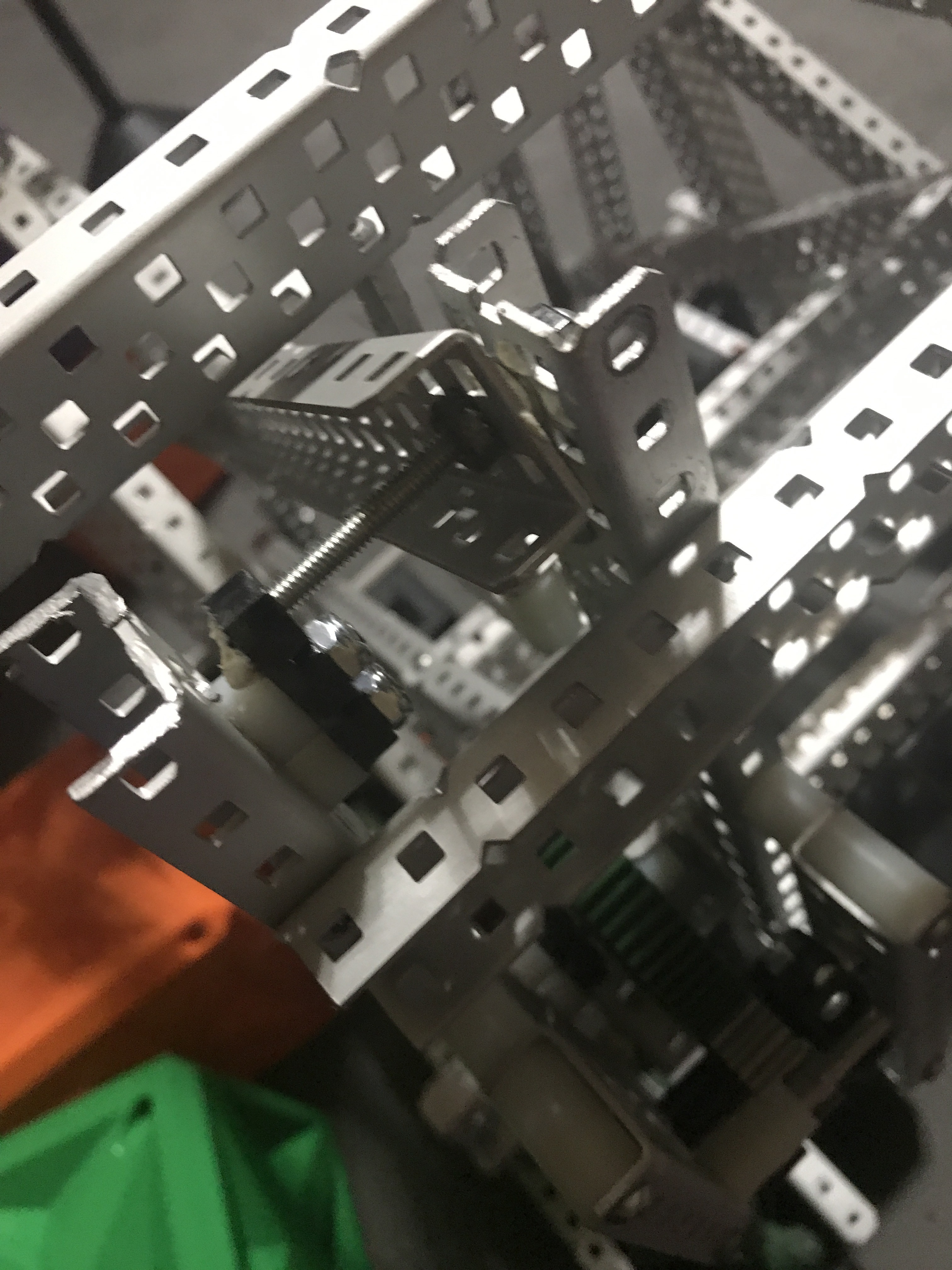

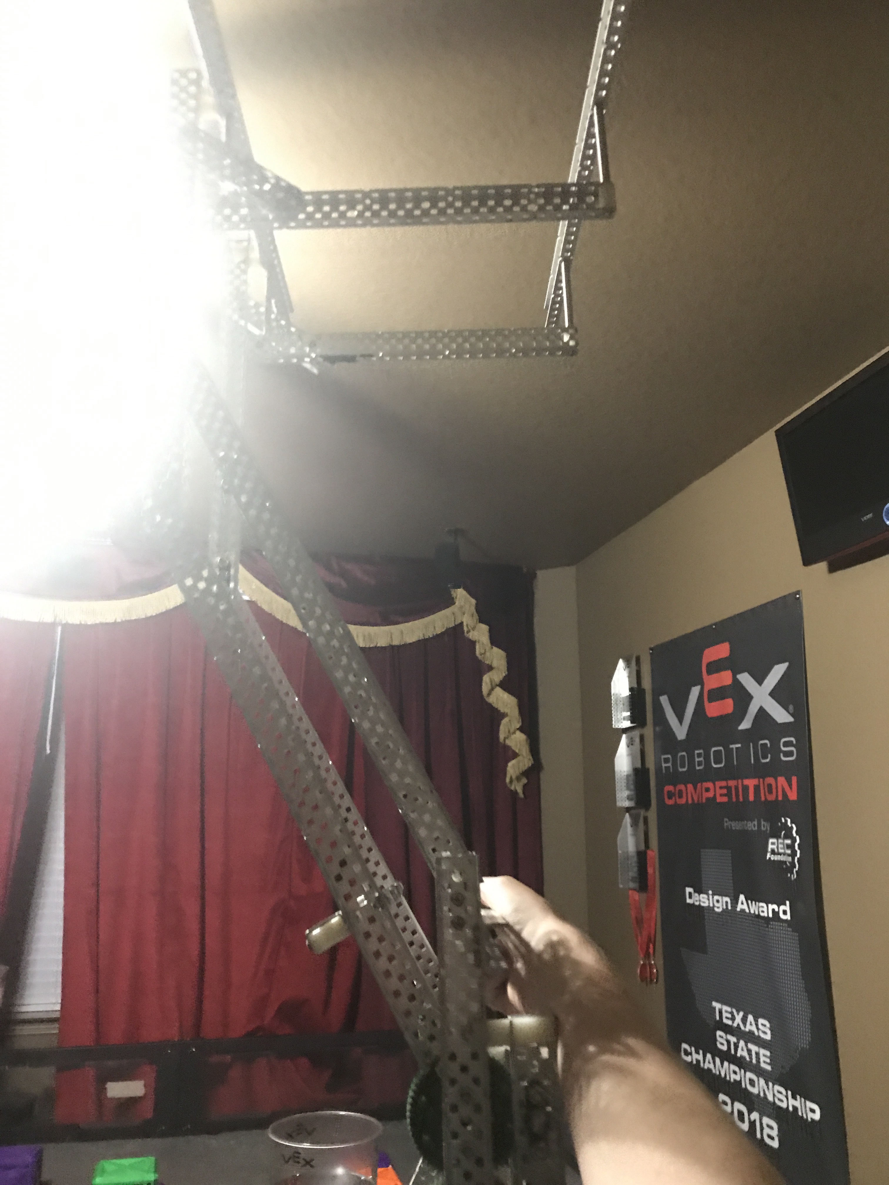

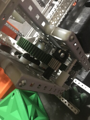

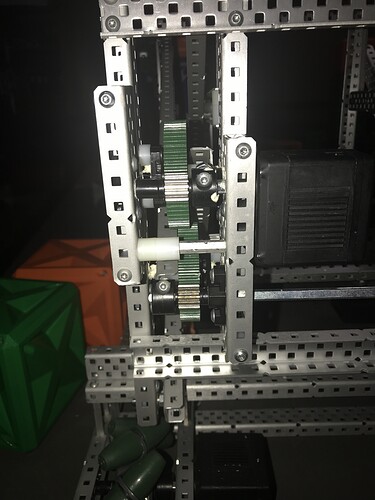

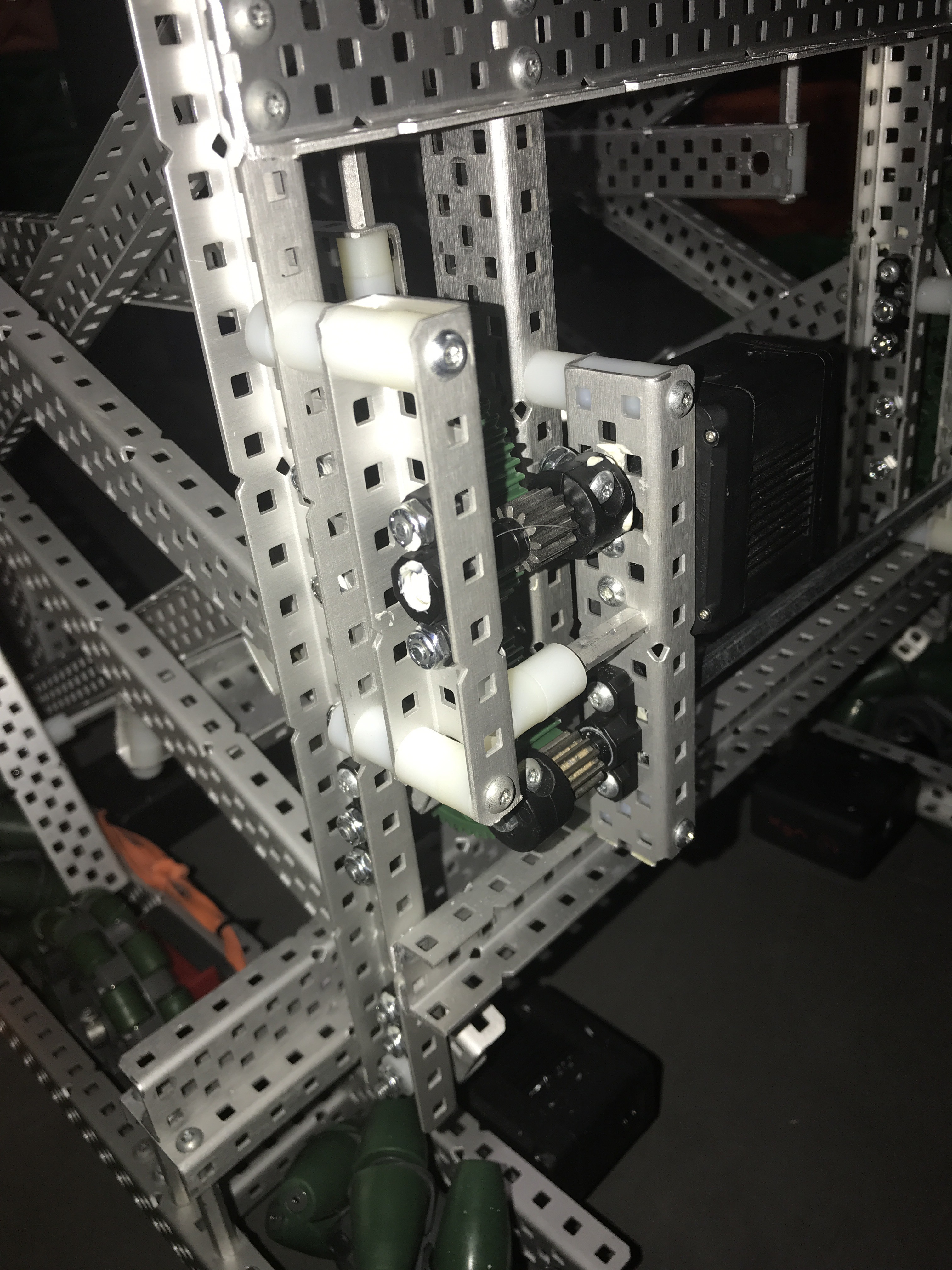

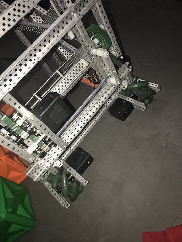

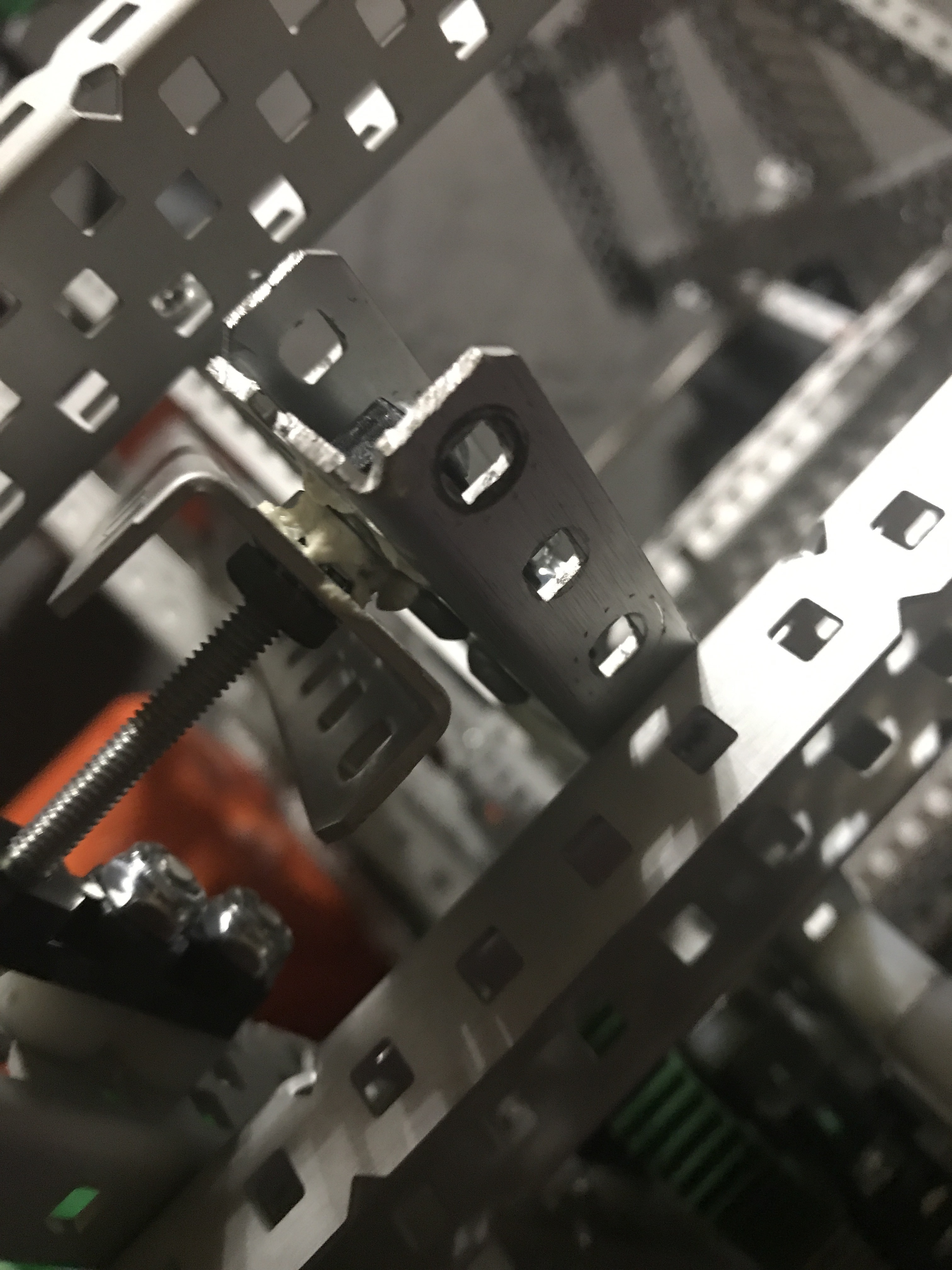

Here is how I did my lift (Unfinished)
Ill let you all figure out why the half-built robot is this way :wink:
But heres what my DR4B looks like as they use torsion blockers, as Ive said in a previous post, for stability.
