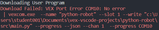

Download failed error
I can’t figure out how to fix this. I’ve tried so much stuff and it just refuses to work, and I can’t figure out why. Using the VEX VSCode extension.
Seems like the code can’t be downloaded because something is wrong with the port COM10.
do you have VEXcode or anything else trying to communicate with the V5 open ?
Is this a direct connection to the V5 brain ?
actually vexcode v5 pro was open in the background, would that mess it up? I’ll try closing that tomorrow
If you have two VEX applications open at the same time, it might cause some interference. This is just my inter Ap csp talking
Yes, both VEXcode and the VSCode extension will be trying to communicate with the brain at the same time, this will generally cause any downloads to fail.
