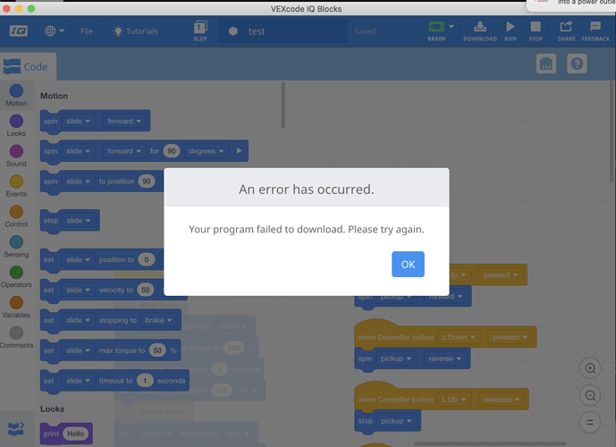

Hi, We have very similar issue where every time we download we get an error, tried all the suggestions found so far and none of them seem to work. If I power everything down (including laptop) and reboot and put a simple 3 line program it works, if I put in a bigger program I get the error - even with the simple program back.
Be great to figure this out. Screenshot of error attached.

Looks like you have a motor called “slide” and also a variable called “slide”. That causes a compile error.
Thank you. Will try that.
Thanks very much for your help, that fixed the issue, such rookie mistake too. Shame the compiler didn’t give any indication on the error.
