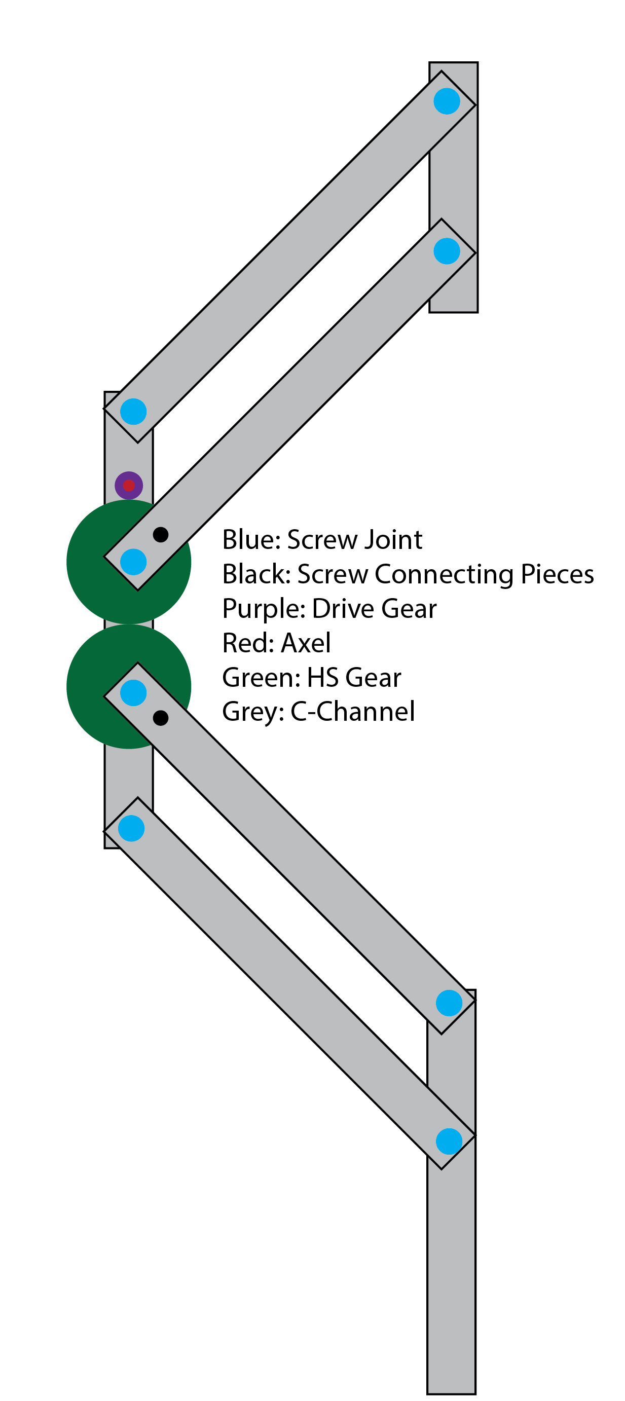

As the lifts are lighter you don’t need to do what we did last year with the overly torqued 7:1 6 motor (4 torque 2 Hs) but I would instead recommend 4 motors 7:1 high speed. It takes a little work to convert and might not work with the way you set your bot up but inverse DR4Bs are super stable. If you make the center towers super close together and try to make the lift as thin as possible you will be able to go straight up easily. Also 2 encoders one on each side can help significantly. Have them try to have the same counts as they move and the lift should* go up straight.
are you saying that making the second stage encompass the first stage is better? my instincts tell me that you’d want it to be narrower as you go up…
Indeed. You want less cross space to increase stability as the lift raises. I’m not sure what this means, or if we’re misunderstanding something.

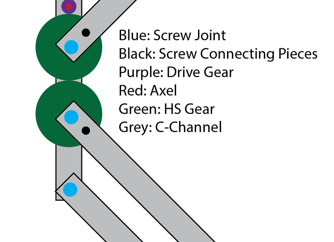

I’m confused: do you want us to put screw joints were the hs gears with the bars are?
Here is a diagram of what I mean along with a robot that has a dr4b on it that is pretty much the same as the diagram. The only difference between the two lifts is that the lift on the robot has an axel on the upper set of gears as they are non-HS gears and I didn’t want to dremel them.
Personally I have built both types of DR4B lifts and a DR4/6B and the the narrower the whole thing is the better. I have found that for me I was able to achieve a narrower lift and more stable lift with the inverse DR4B
if you say so… never seen it done that way before.
