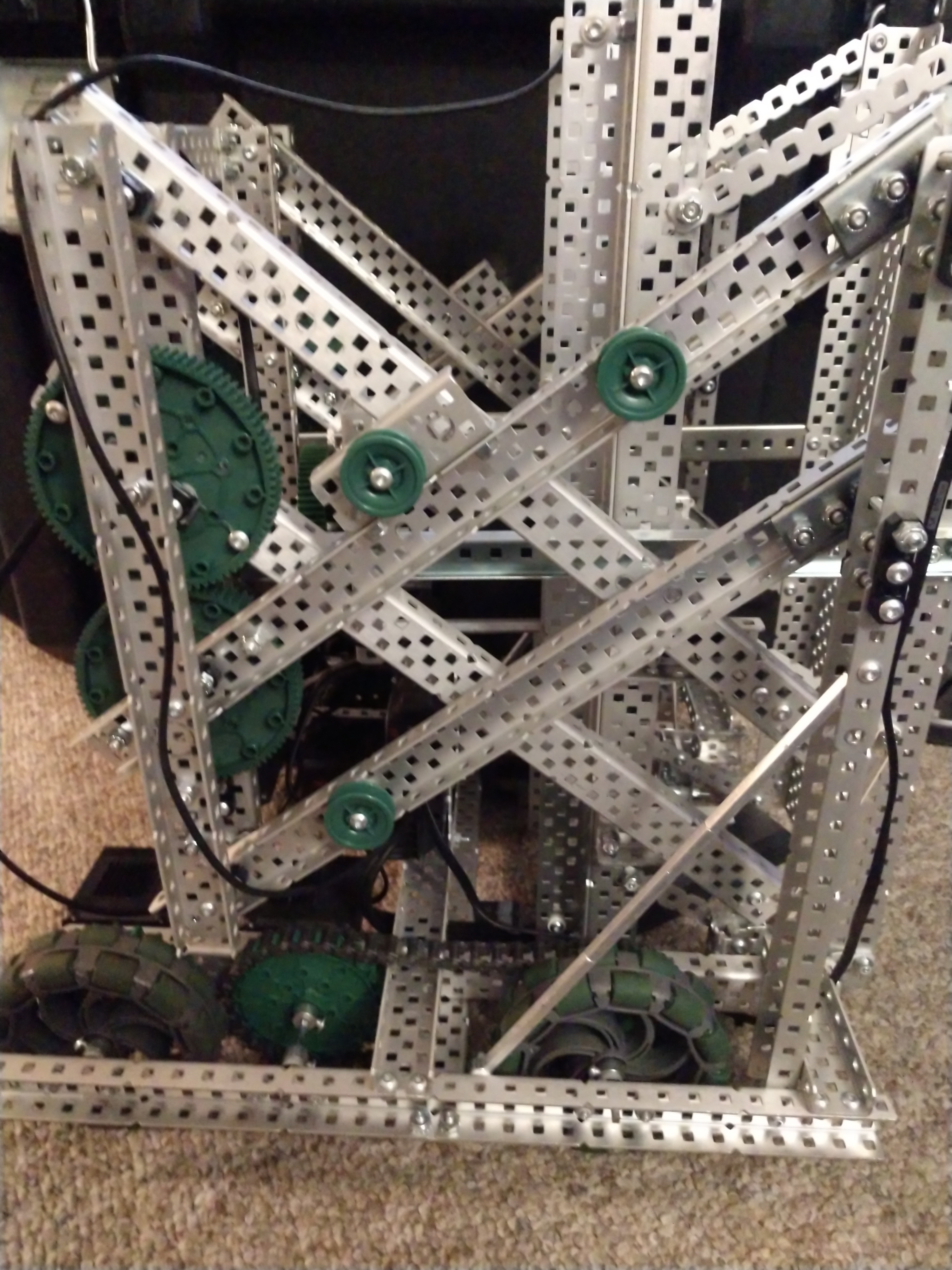

I have a big issue and i have a competition tommorow… I really need help. Im using an 8:1 gear ratio and for some reason my DR4B wont lift at all… Now i know that sould be a good gear ratio for this… Im stuck ive tried everything so ill take all the ideas i can get

So use the black rollers on a screw . Make sure the rollers still…roll and that you use a lot. I saw a dr4b lift just because of rubber bands. Do you have a picture of the robot

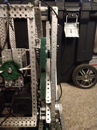

Its powered by a 12 tooth gear in the center
If you can see there is a motor there

So use those where you put your rollers at. Put a screw though so they will still spin. Put rubber bands in that triangle shape but this time, the rollers will allow them to move and force the lift up. Would suggest a lot. Check your gears for teeth messed up and the inserts you put in the gears to fit those small shafts, make sure they are still inside. Also check the drive shafts if they are connected to motors. Is your lift all aluminum
