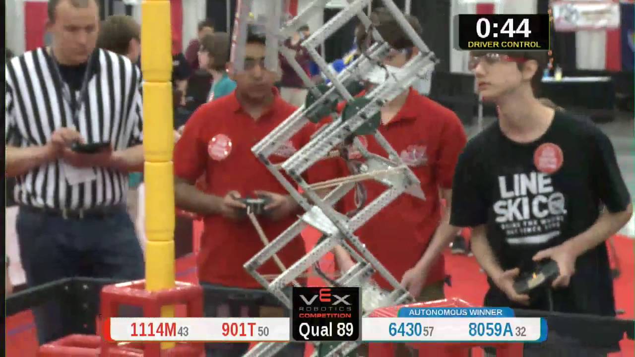

I saw a lot of teams in skyrise use DR6B. So I wonder if a DR4B isn’t tall enough for an entire skyrise.

And yes, no DR4B is tall enough to build a full Skyrise pole.
A full skyrise was 60". 20 cones is 64.25", so I think we’ll start seeing similar heights midseason at the latest.
As for a DR4B, a decent estimate of height would be 18" tower + 18" first 4 bar + 4" for gears + 18" second 4 bar = 58" + object manipulator.

In Skyrise there were a few teams that could do it, including the MS World Champions, 8066 teams and also some other teams form Singapore i think, like some of the 8068 teams. But majority of the RD4Bs were unable to score a full Skyrise.
Correction: Also the 8059 teams.
All Singapore teams used dr4b for skyrise.
dr4b is tall enough.
