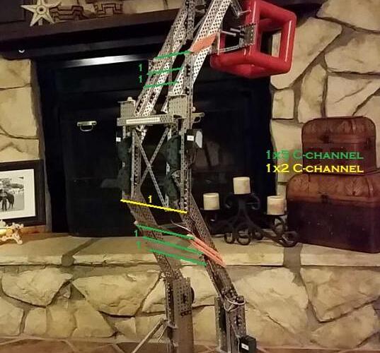

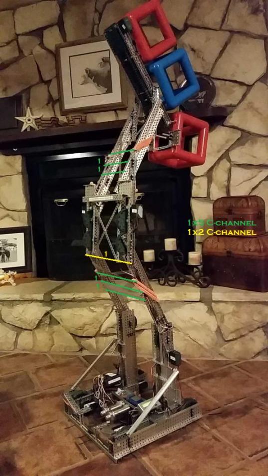

dr4b tilting.
A few simple mechanical things that might be the issue:
  • Make sure the rubber bands on each side are equal
  • Make sure the pivot points are the same (correct) tightness
  • Make sure there is not binding or extra friction in the gearing or pivot points
  • Slightly pull the axles from the motors and move the lift by hand to try to find specific bad spots
  • Make sure you’re using all the same gearing in your motors
  • Make sure everything is symmetrically balanced.
  • Make sure your entire lift is square (the arms are 100% parallel)
