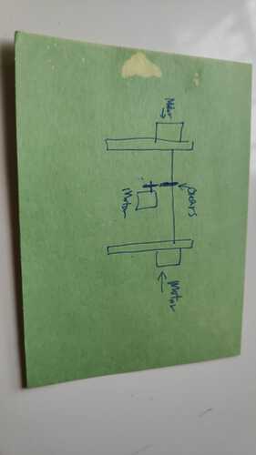

How would you mount 3 motors on a DR4B, would it acheive equillibrium?
how did you mount the rubber bands?
you can, just put one in the middle. Here is my rough sketch:
