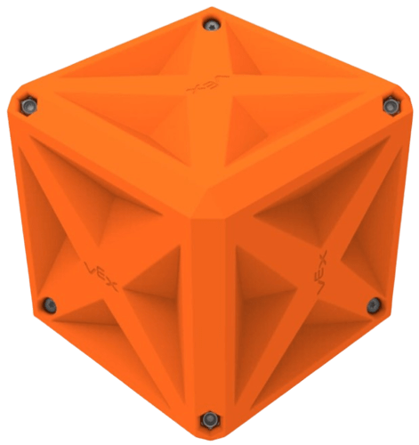

Sorry I neglected to state I was using VexCode C++. I have looked at some things on the forum and came up with this code
#include "vex.h"
using namespace vex;
// A global instance of vex::brain used for printing to the V5 brain screen
vex::brain       Brain;
int main() {
    Brain.Screen.drawImageFromFile("cube.png",20,20);
    while(1) {
        // Allow other tasks to run
        this_thread::sleep_for(10);
Unfortunately this will not draw the image.
The only thing I can think of is that your image file is not in the correct location or is nonexistent, it is not the correct dimensions or encoding, or that your SD card is not properly formatted.
Make sure your sd is formatted with fat32.

perhaps attach the image to this thread, as @theol0403 suggested, it’s probably too large or something simple like that.

I put the image in and I attached the image in a zipped folder in case that wouldn’t work. @jpearman what are the limits for images?
(Yes there is no background on the cube)
cubeimage.zip (191.8 KB)
You want to resize the image to 480x240, as that is the brain’s resolution.
Since the image is square the best you can do is resize so the height is 240.
Ah excellent! Thank you very much everyone! Resizing solved it.
