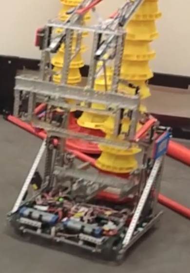

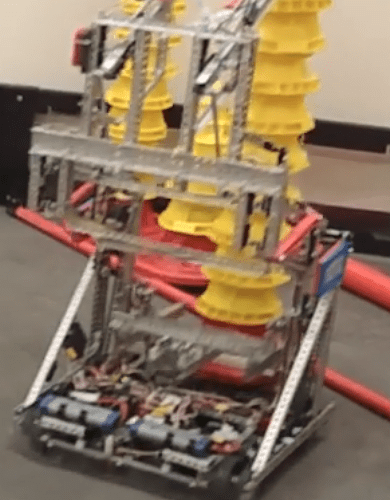

I don’t think I would be too surprised, considering I drove a DR4B-based lift robot for… well, the entire season. If there is a lot of weight, just make it lighter. But I promise you that it does not compare to a nonlinear lift of the same height, with the same weight at the end, etc. Here is an image that includes the back section of our DR4B. Pretty darn light.
You may not want to make that promise. Consider this: DR4B that has lengths of 12" for each arm v. the same design with 8" on the lower arms and 16" on the upper arms. They’ll lift to the same height, but the second isn’t linear. However, in the case of the second, all those motors, gears, etc. on the back move horizontally less than with the DR4B. So depending on what you’re holding and the weight of the claw, this non-linear lift could go to an equal height and move the center of gravity less horizontally. Edit: Actually, what is being lifted will move back slightly, counteracting the forward motion of the midsection. So there will be a lot of leeway on what claw/load weights are lifted for this non-linear lift. (For clarity, that is bottom to top and so a sort of average. In the middle the claw/load will be forward a little.)
