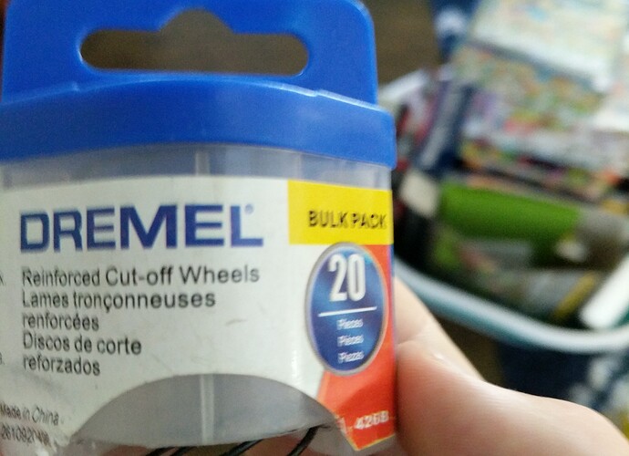

I use these heads
I mostly use them for Axel’s but there “ideal for metal”
There about an inch in diameter

My final method was a dremel and a reinforced cutting wheel. It works great. Make sure you wear safety glasses, I often had metal dust fly up towards my face,
