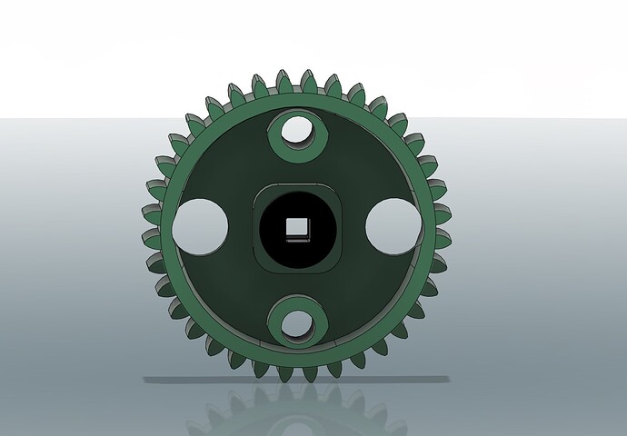

I designed a 2 Speed Transmission just for fun but decided I wanted to physically make it. I went for a designed inspired by 44F’s were the gears slide along some standoffs so you dont have axles poking around. im afraid of destroying too many gears and my teacher wanting my head on a pike. is there anyone with experience in something like this that can tell me what to do?
You might want to post a link to the design or your CAD drawing. I use a drill press to drill though things like gears.
I have this one https://www.amazon.com/Dremel-Workstation-Portable-Drilling-Perpendicular/dp/B00068P48O that I got in 2017 and I’ve been very happy with it. It will do 3/16" holes pretty easily.
Does your school have a machine shop and good machine shop teacher? If so, ask your machine tools teacher about sharpening a drill for plastics with a 90° point and zero rake angle. (and record this information in your engineering notebook about why “plastics grind” drills are a thing, and how you learned to do it).
You can certainly drill with a regular point drill, but the plastics-grind will work better, as it doesn’t have the tendency to “screw” itself into the plastic material.
this is what i want to do to the gears
Yep, drill press. Take your time while drilling them.

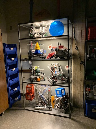

44 top shelf - literally :slight_smile:
that picture is in old shop - new shop (next room over)…
