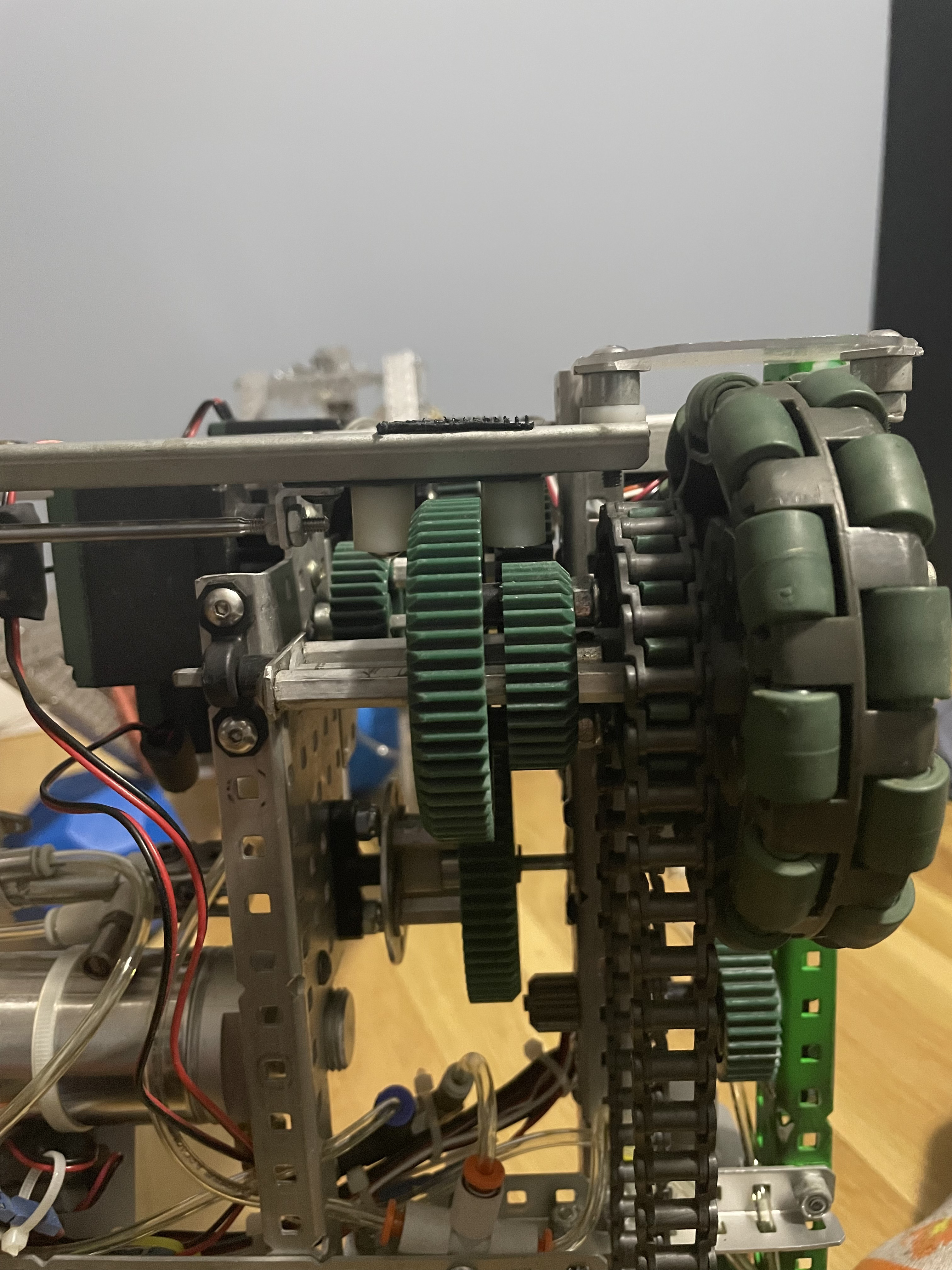

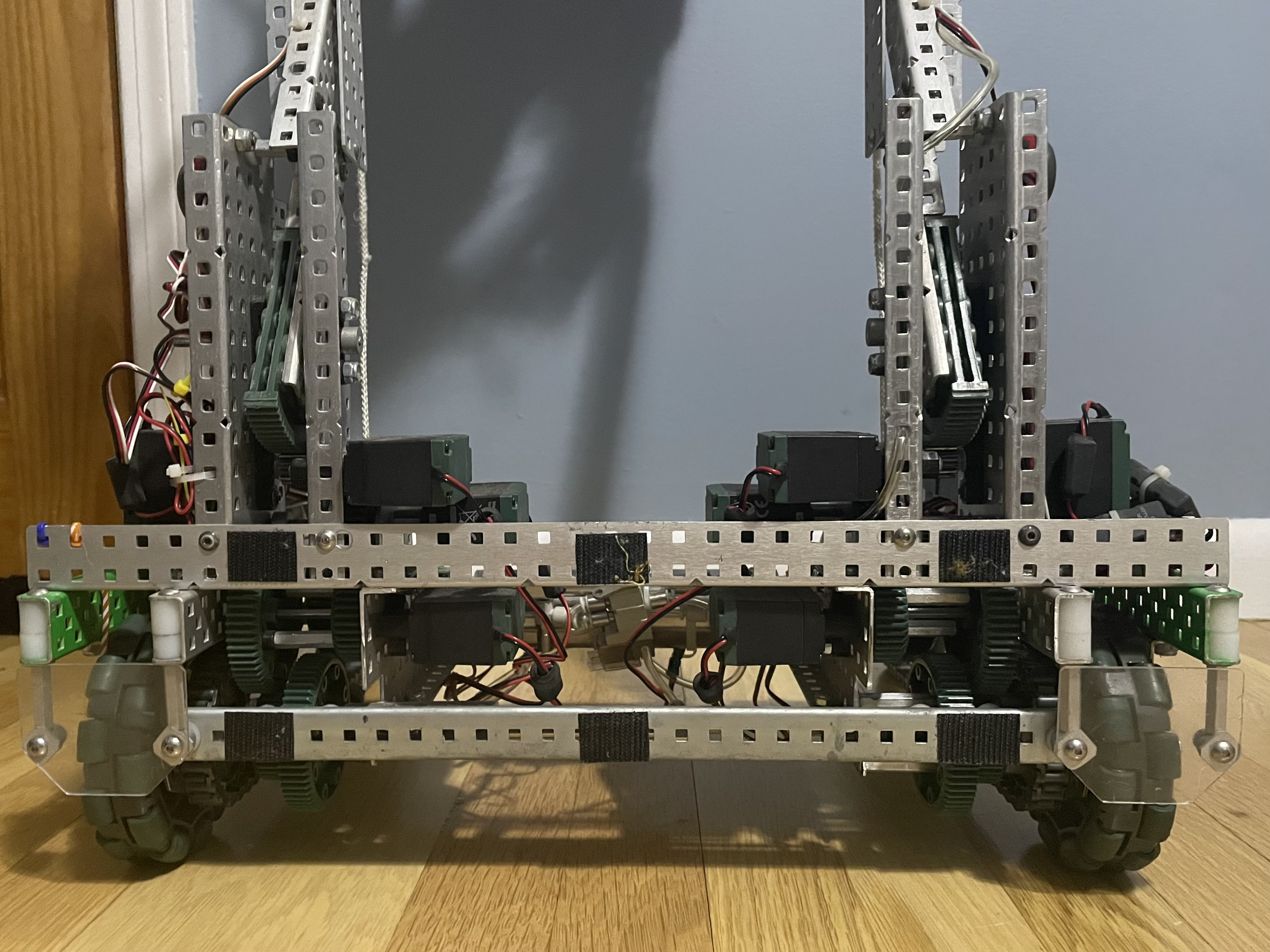

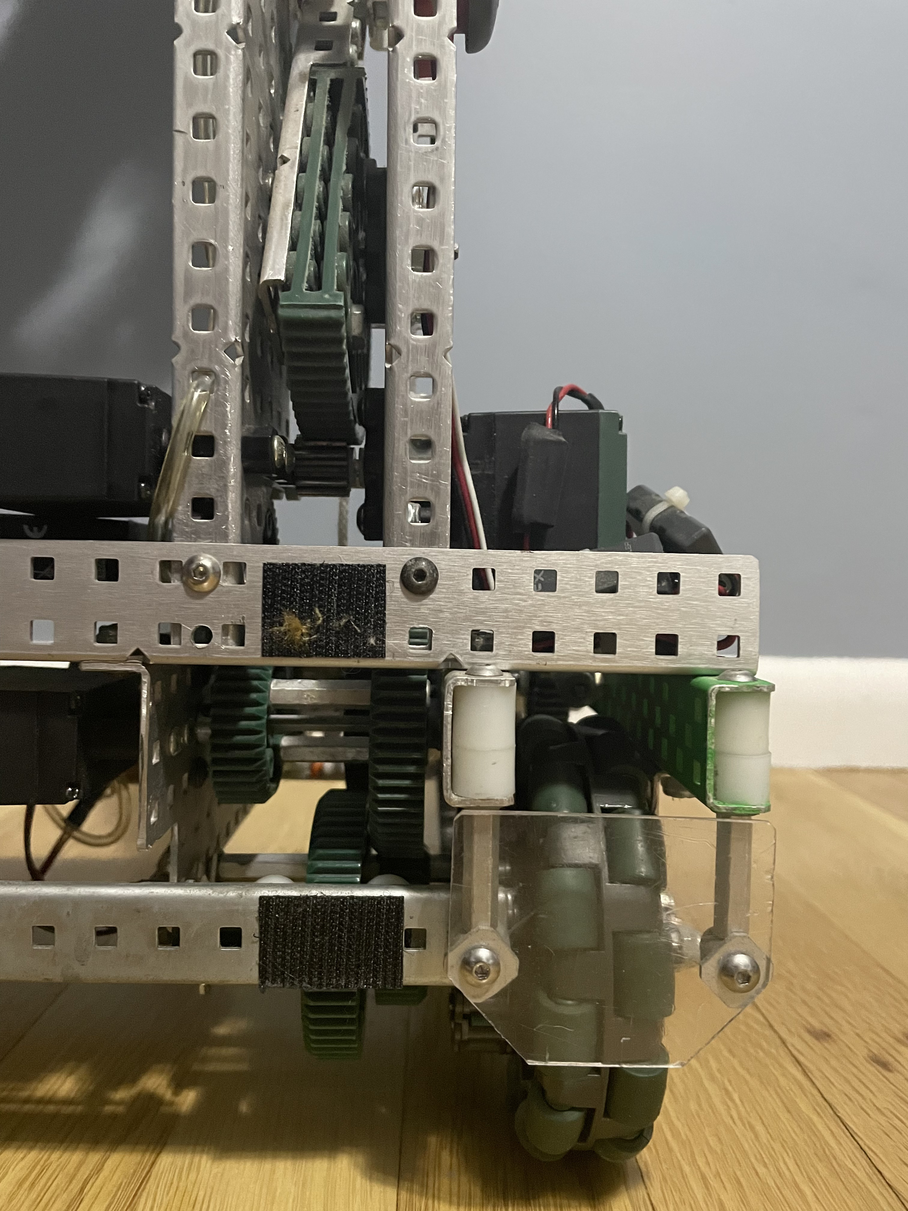

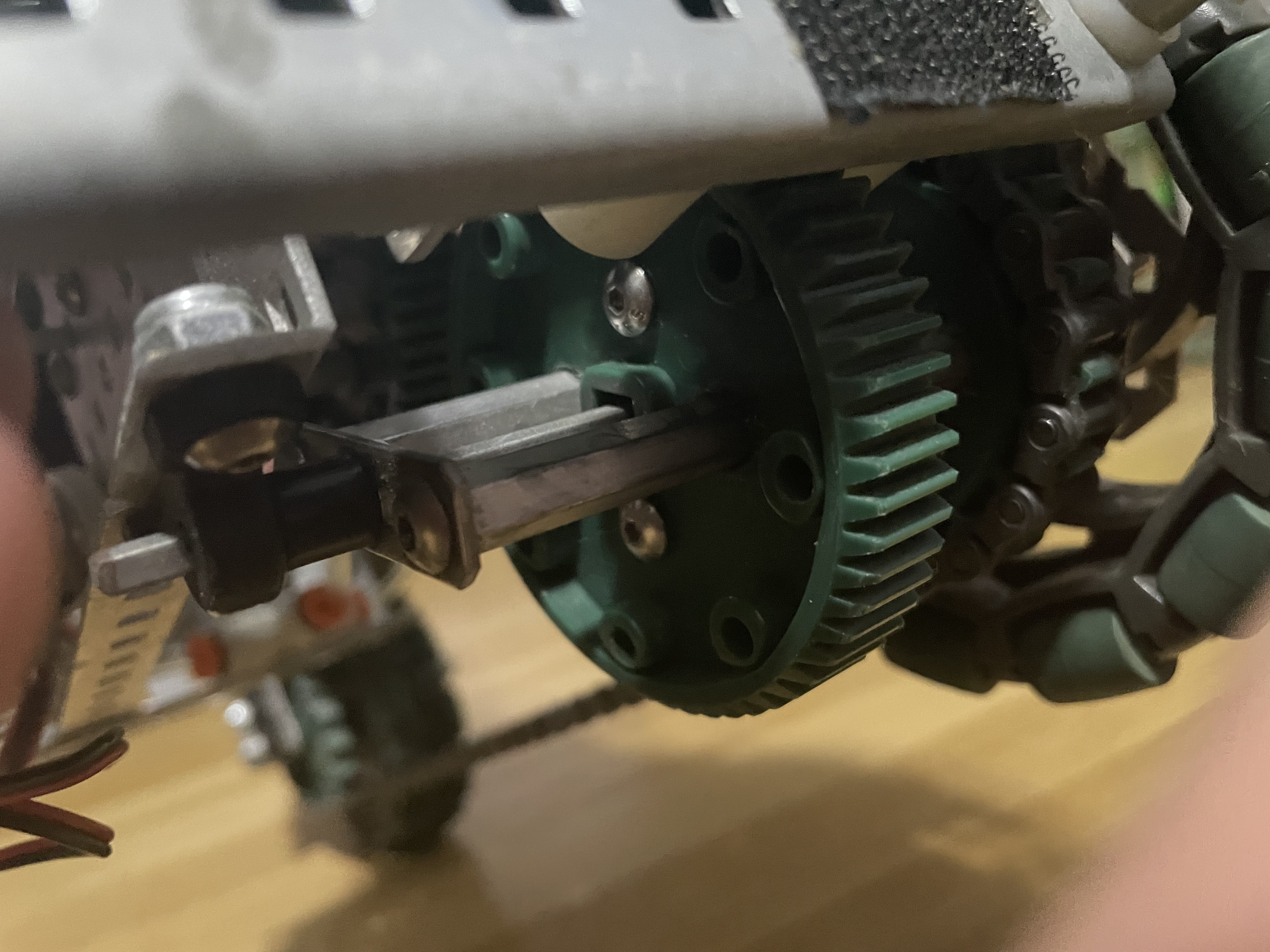

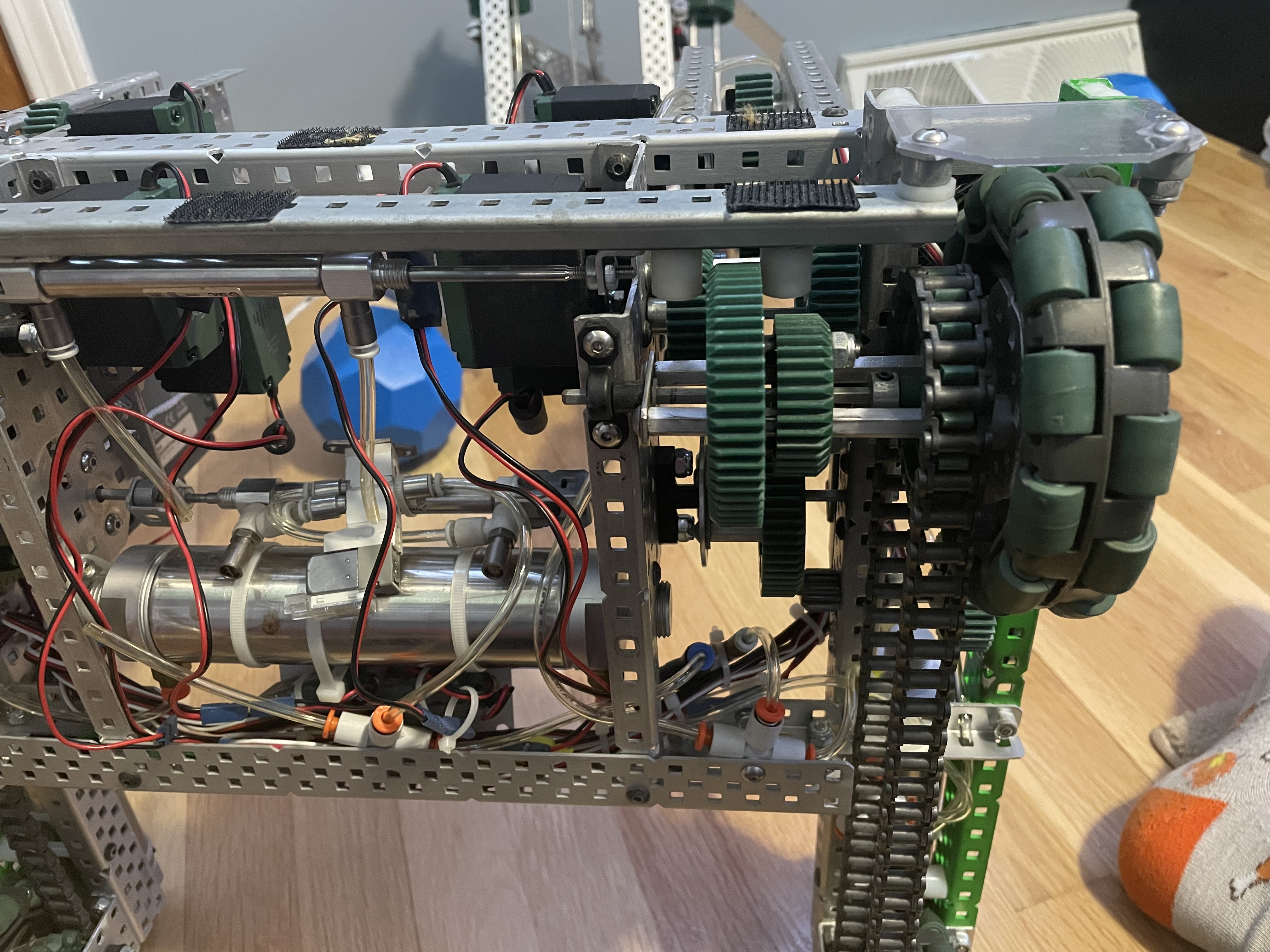

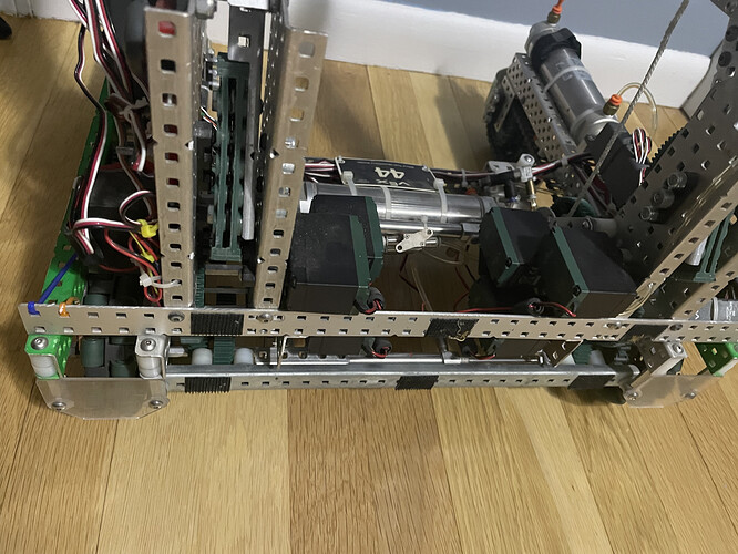

Hi y’all,

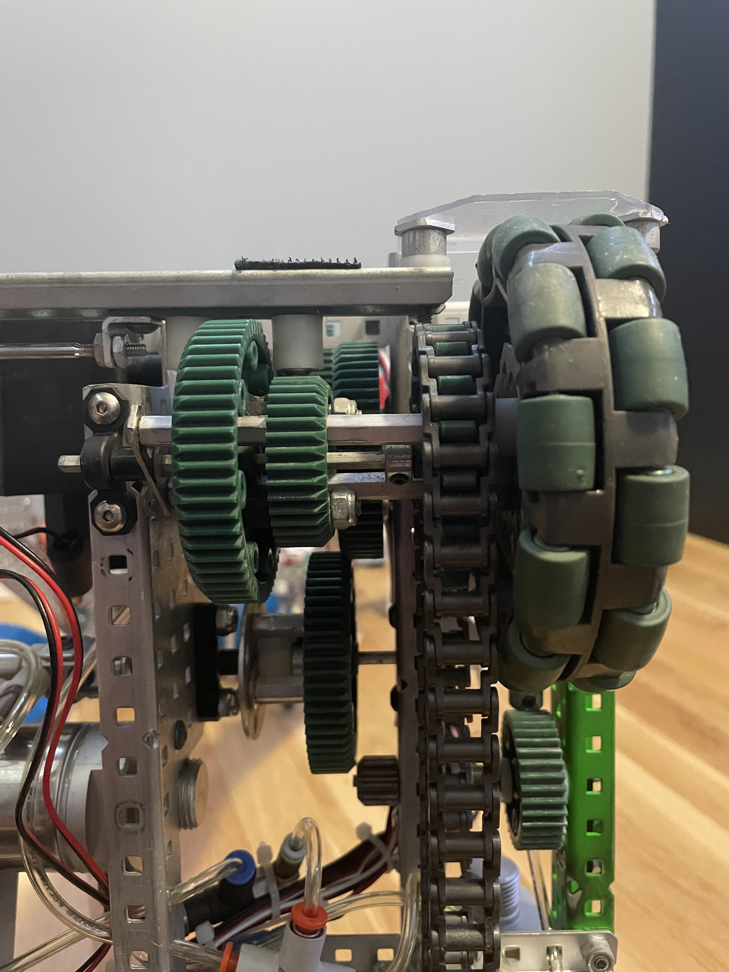

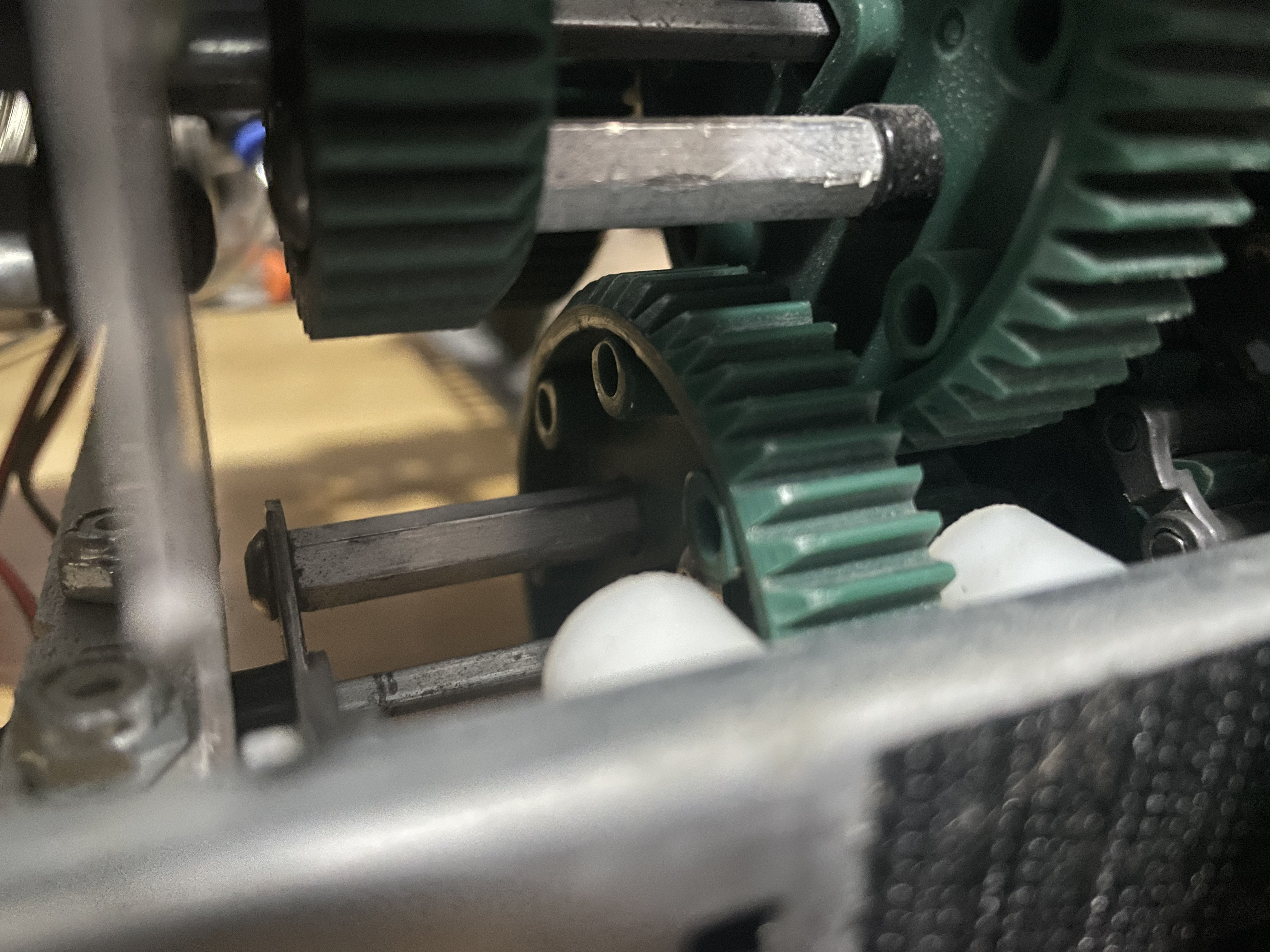

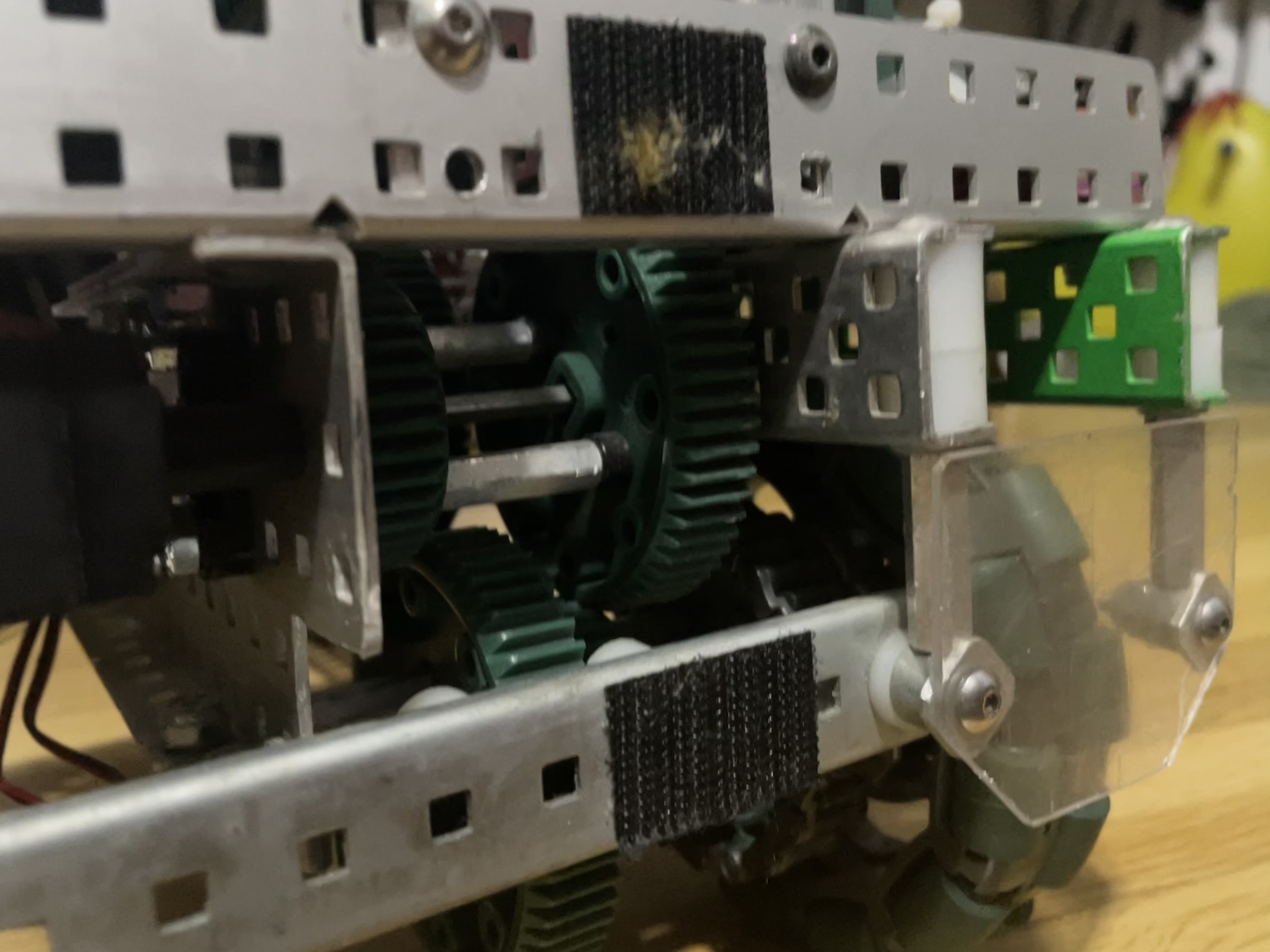

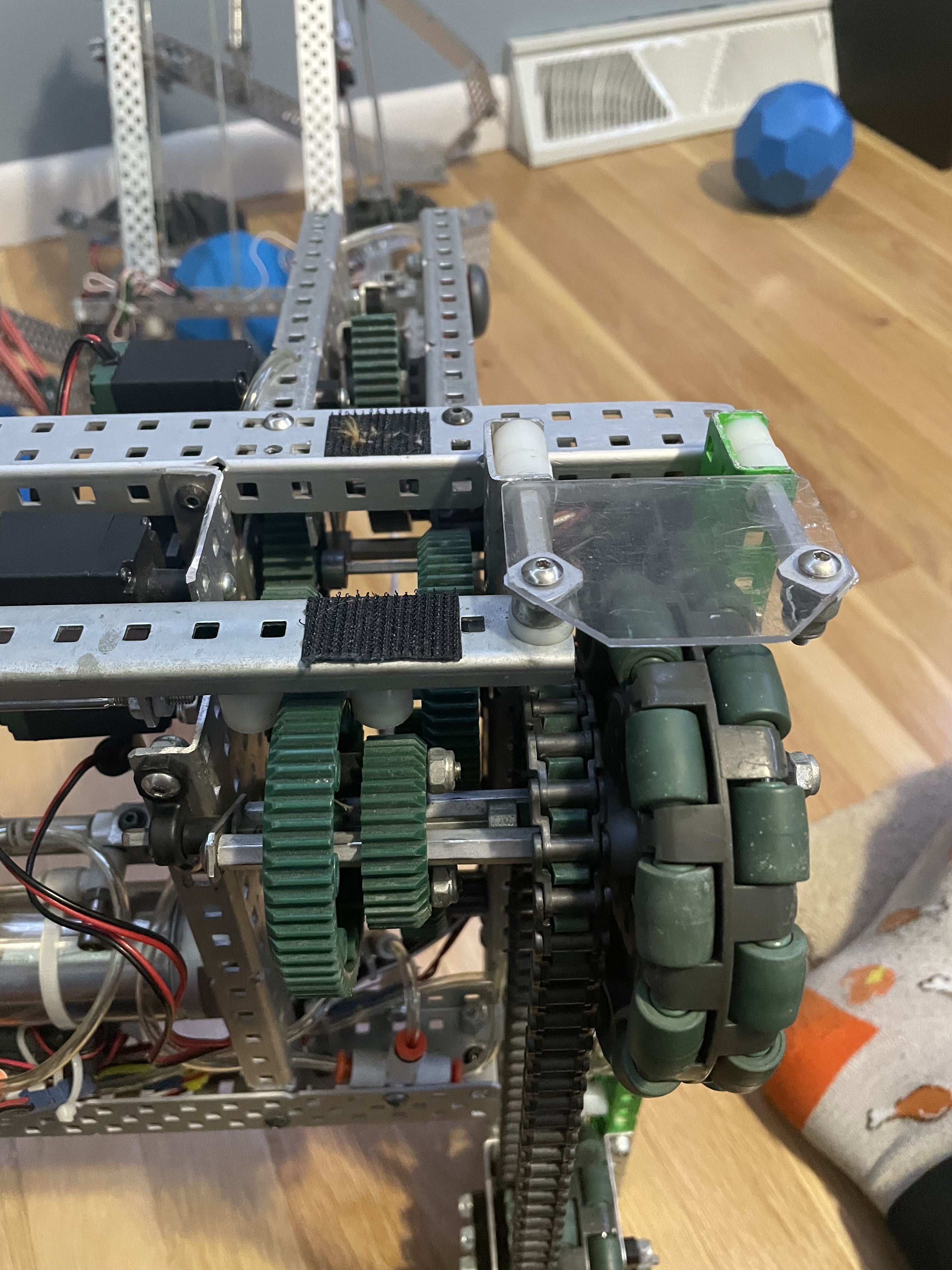

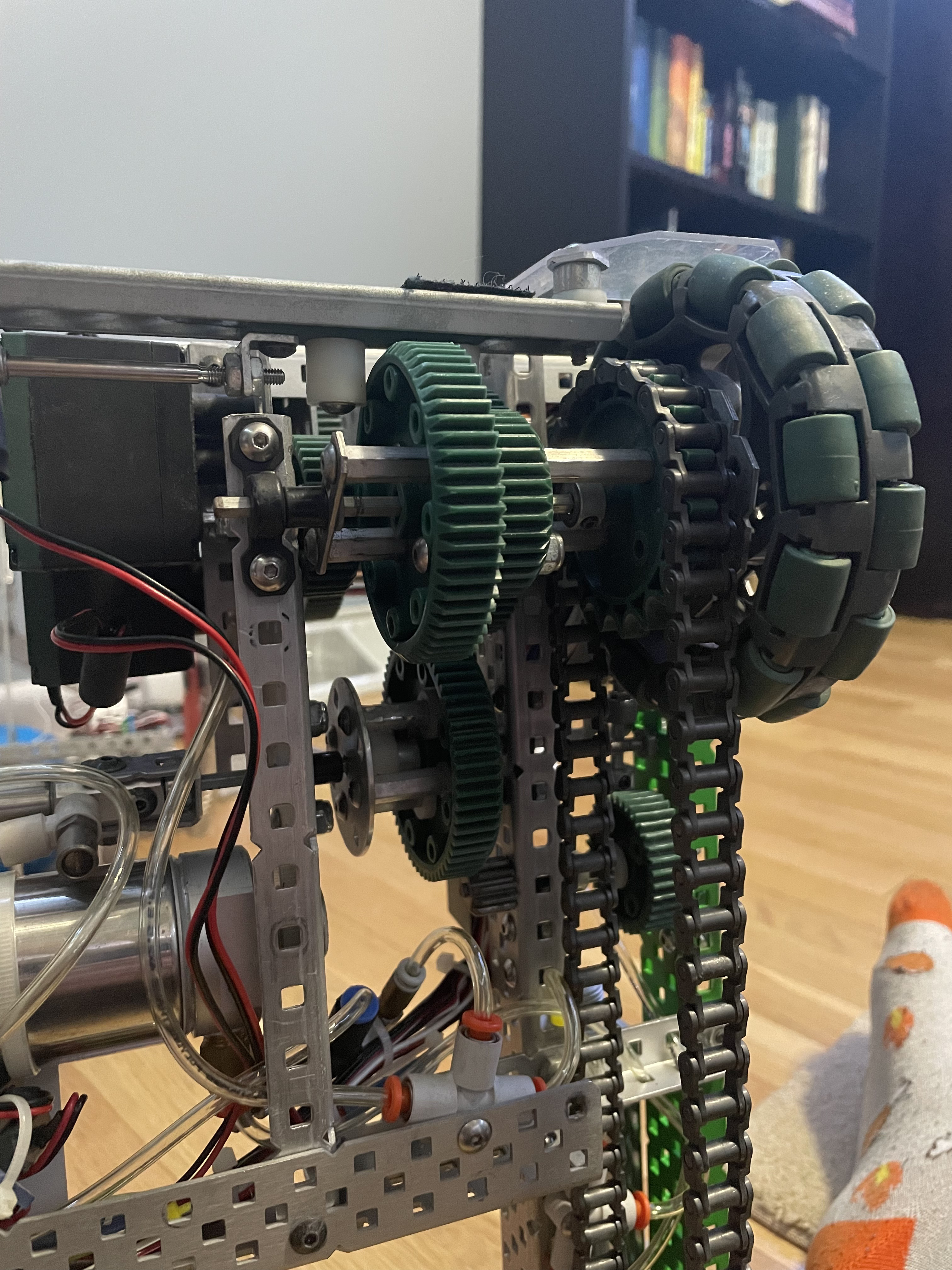

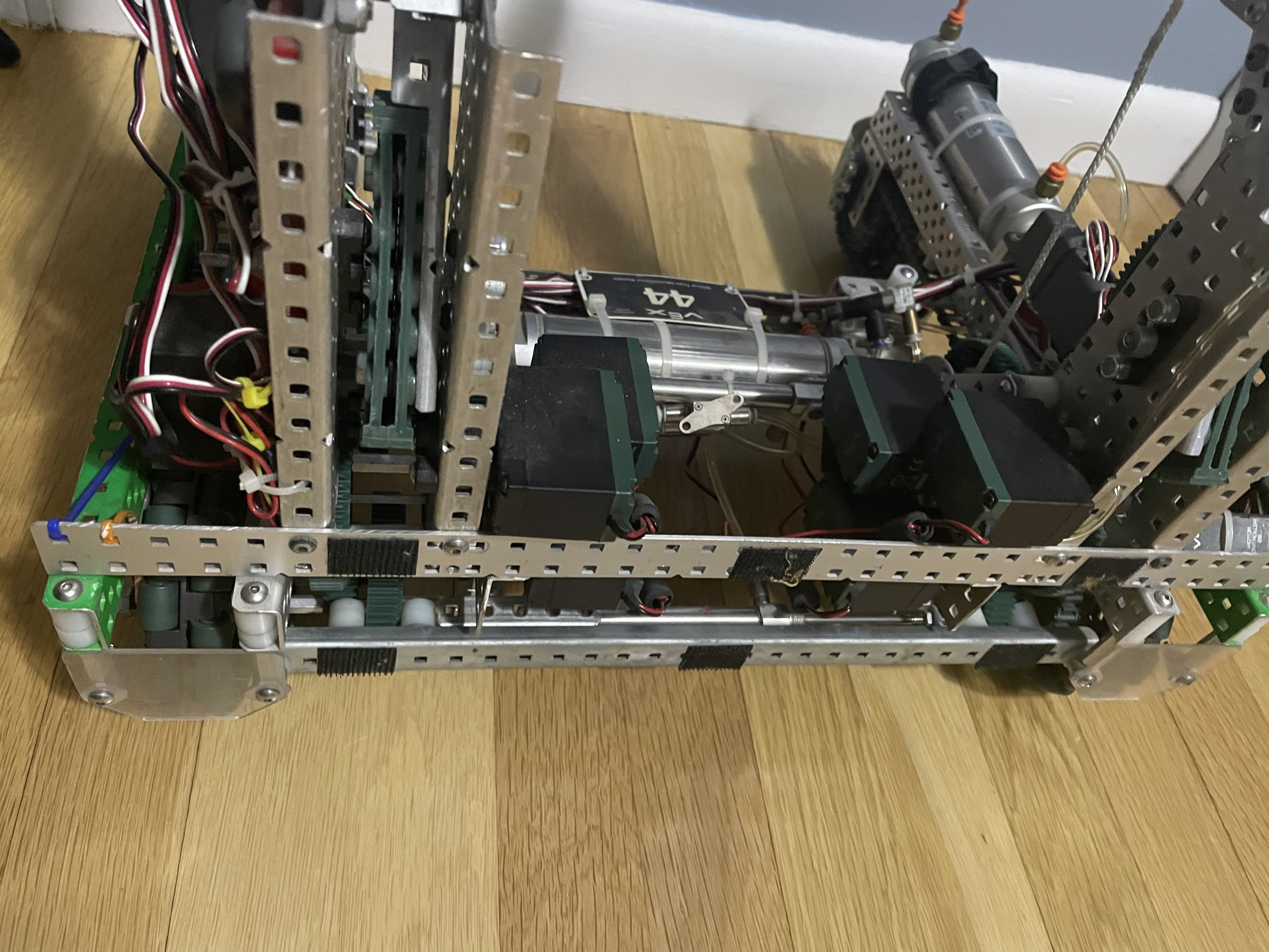

Sorry for the long wait, but here are some pictures of 44s Toss Up robot transmission I took (warning I’m not the best photographer ). As you can see the gears are drilled for the standoffs to go through the two gears. As for the rest of the transmission, It is just a one double-action piston that powers the whole thing.
I’ll link some photos and videos of everything, (Sorry the videos may have to be downloaded) and I do have the robot for the rest of the weekend if anyone wants any specific pictures or any questions, I’ll try to answer to the best of my ability. (Everything is being moved by hand because a lot of the pneumatics are disconnected and so forth.)
