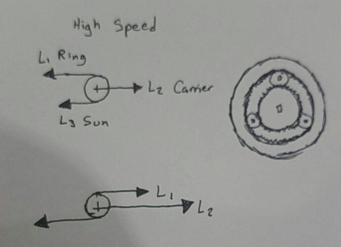

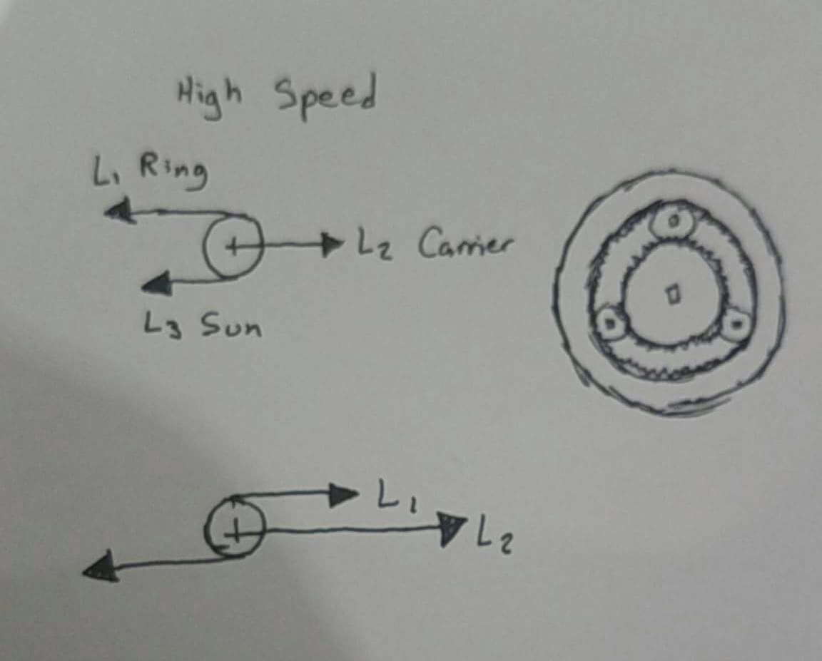

Way beside the main point, but i was doing some sketches and playing with some math on planetary gears and realized that they can be (at least partially) modeled as a pulley system!
You may run in to problems since strings only support load in tension, not compression. But for the high speed config, it works!
