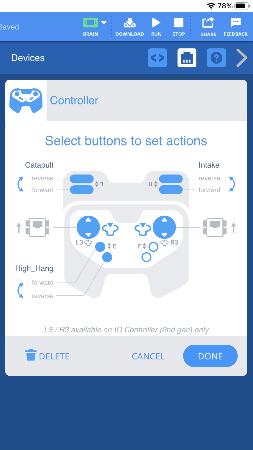

So we are having a frustrating issue where everything but our drivetrain works in the drive code. We know it’s not mechanical or electrical because it works in driver control. This is what our code looks like.

How do you have the controller set up? Have you selected a stick control mode in the controller?

Yes, here is how the controller Is
set up.

It looks like your controller setup is as I’d expect it to be. What happens if you remove the “drive” blocks from your top “When Started” block? In particular the drive velocity and turn velocity blocks, those could potentially interfere with controller commands, since generally the velocities are set by control stick motions.

Ok, so I removed those blocks and it now drives, it’s just now it drive backwards

Woohoo, good guess by me! In the drivetrain setup, just click the other arrow that is above or below the robot (whichever one is not selected) and it should be fixed.

Yea thanks for the reminder. It’s still being confusing as we changed the direction of the arrow and it’s still going backwards. Any suggestions?
All the times I’ve done that in the past with the drivetrain, swapping the arrow direction just works. Make sure after changing the arrow direction that the updated program downloads correctly, that’s the only thing I can think of that would cause it not to work (if it wasn’t downloaded or didn’t download correctly).
