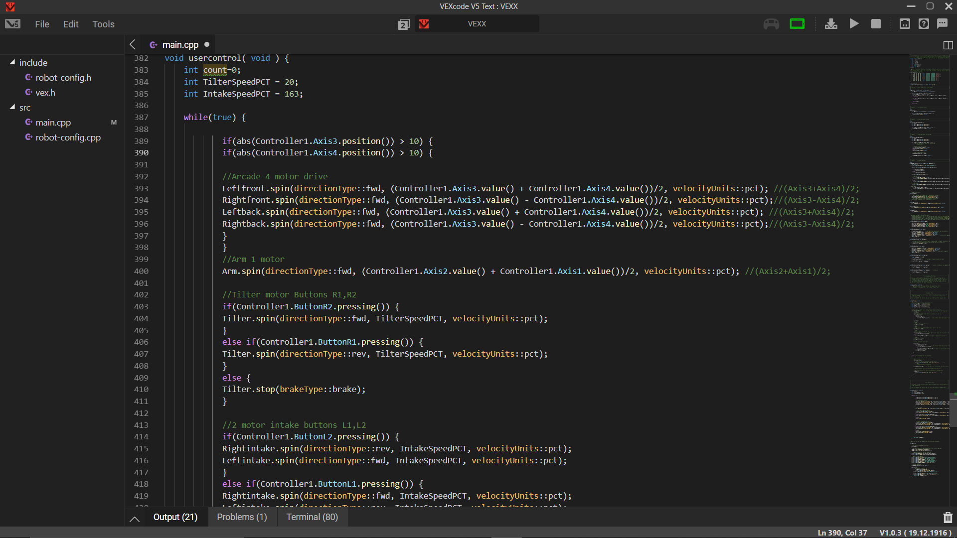

I tried the example that kevjar gave and it still moved forward without any user input on the joysticks. No matter what values that I inserted. What should I do?
can we see your code? there may be some other part that is making your motors spin

Ok, we tried that also, there was no change. we are amateur coders and I just changed the arm motor to only be on one axis.

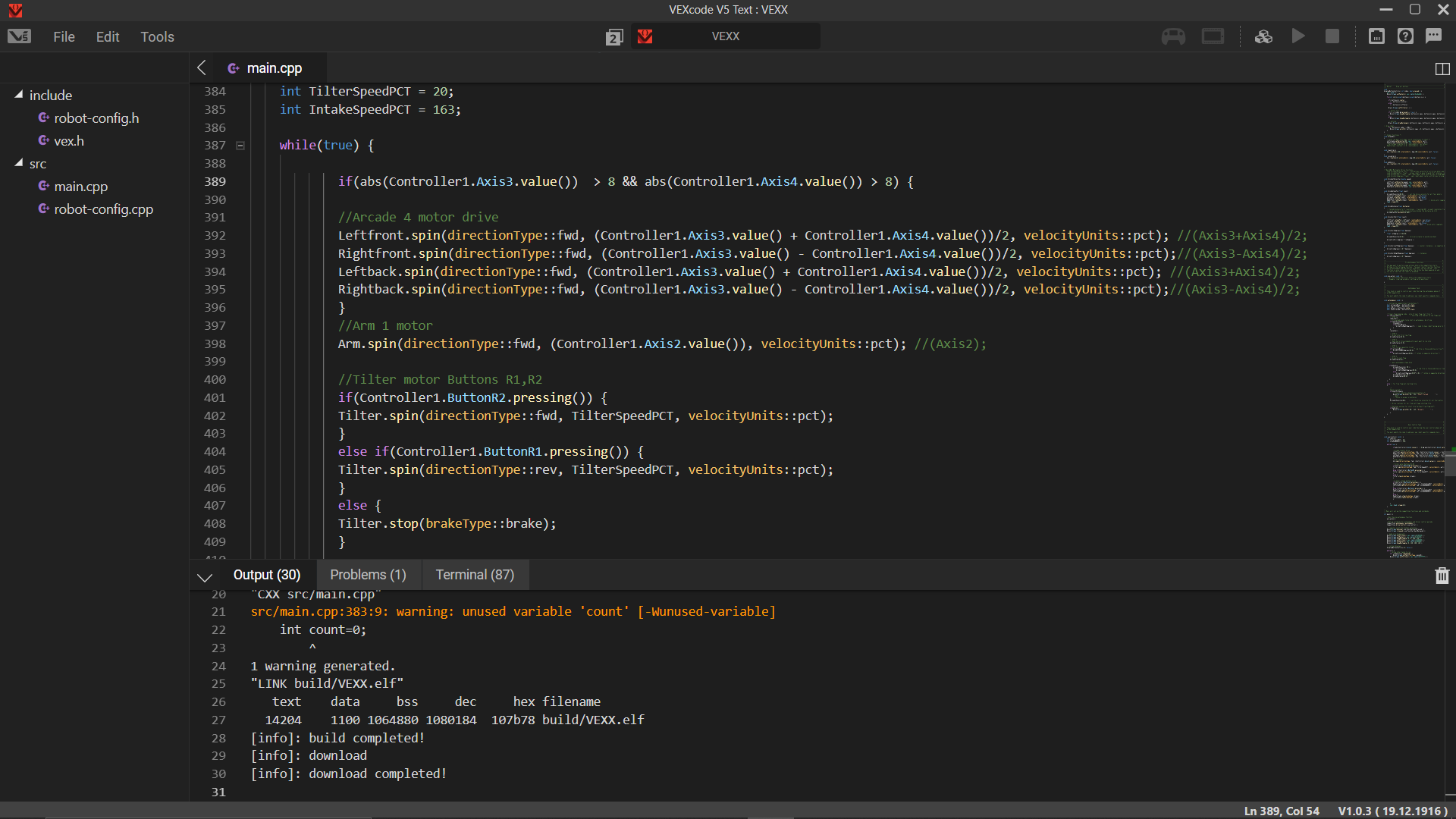

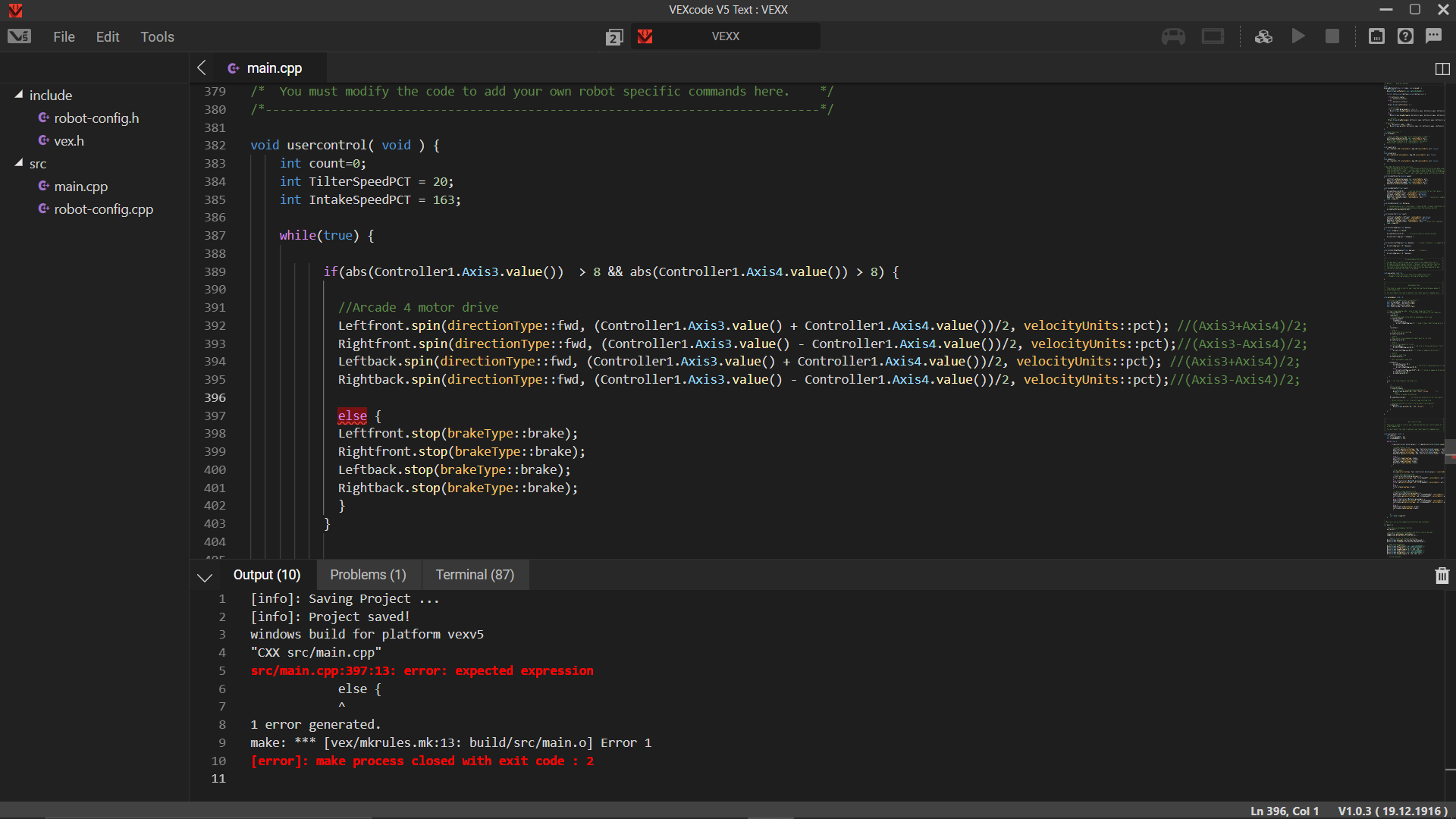

I wrote this, and it doesn’t like the else statement. Any suggestions?
conditional expressions take this form
if( condition == true ) {
  // code
else {
  // more code
you are missing the brace before the else statement
Thanks sooo much! It is finally working. you all are the best!!!
