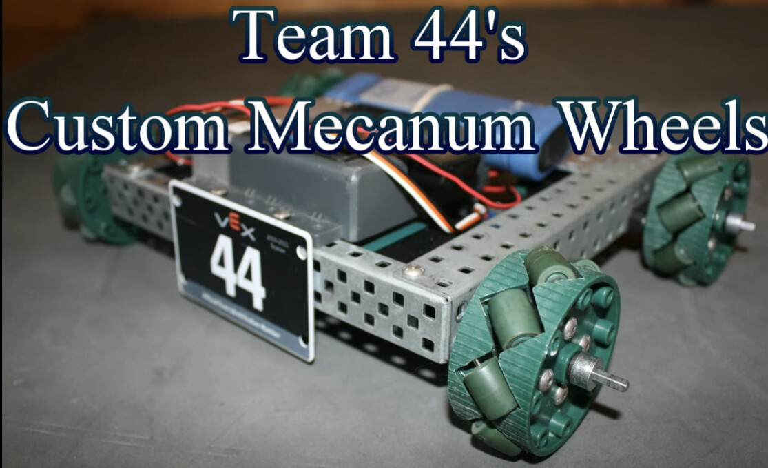

Team 44 is a really good team but they are a team with extremely high dedication. They even built their own mecanum wheels one time:
But, although team 44 had a transmision and used them in 2014, it is obvious the meta is NOT to have one with V5 in VRC. If transmissions were the meta then you should have expected one in VRC during Turning Point season at least making RR. But since there has not been, as what I am aware of, I believe this is due to the sheer power of the motors that can just destroy the gearing of transmissions with shock loads.
