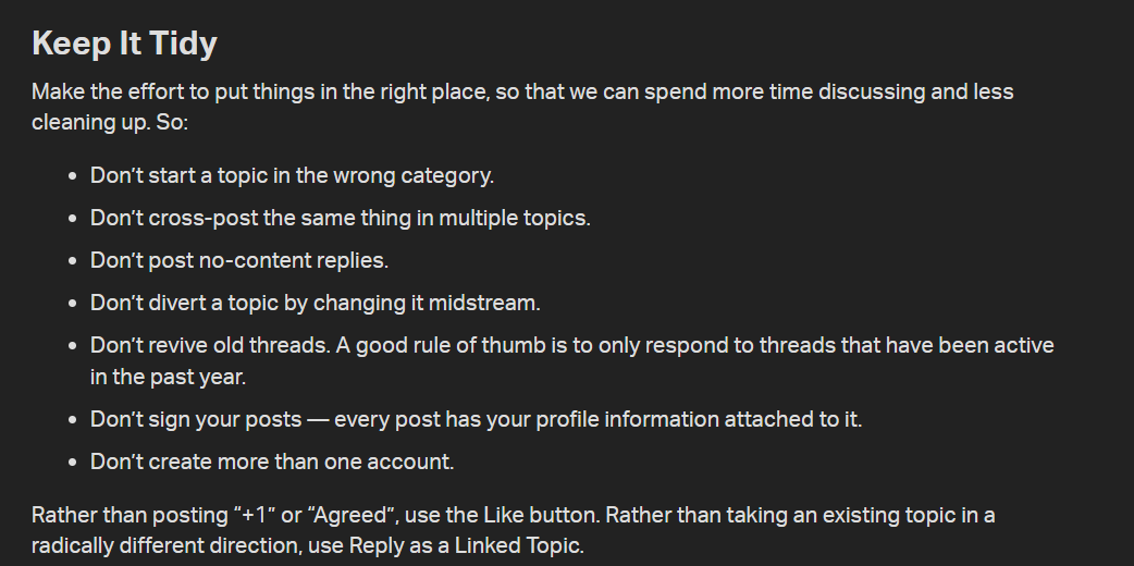

Welcome to the forums, just letting you know before someone yells at you. Don’t sign your posts
