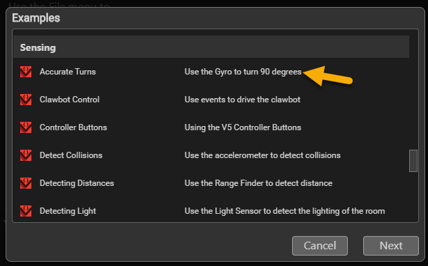

I wanted to use “drivetrain” because of the easy gyro integration in auton. How can I use Gyro for precise turns and straights in auton withouth the “drivetrain”?
Thanks
If you go to File > Open Examples there is an example called ‘Accurate Turns’ under the ‘Sensing’ section. This example gives you an example of how to use the Gyro to make 90 degreee turns without using the DriveTrain object:
