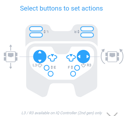

I don’t think you understand. I am trying to configure the controller to various motors in a method involving you going to the controller section of devices. Let me show you in a picture:
Screenshot 2024-01-01 9.14.38 PM
My current incarnation of my drivetrain code, where the left joystick controls the forward and backward motion of the robot, while the right joystick controls the turning of the bot.
As you can see, the system pre-formats for code regarding a drivetrain and is only applicable to the joysticks, hence why I was referring to “joysticks” in my first post. I have tried reversing the code (the right joystick is controlling the forward and backward motion of the robot, while the left joystick is controlling the turning of the bot.), but to no avail. If you (or someone else viewing this post) can help me with this or even suggest a working drivetrain code (as me and my experienced coder on my team is stuck, and with the rest of my team being inexperienced in VEXcode IQ) it would be greatly appreciated.

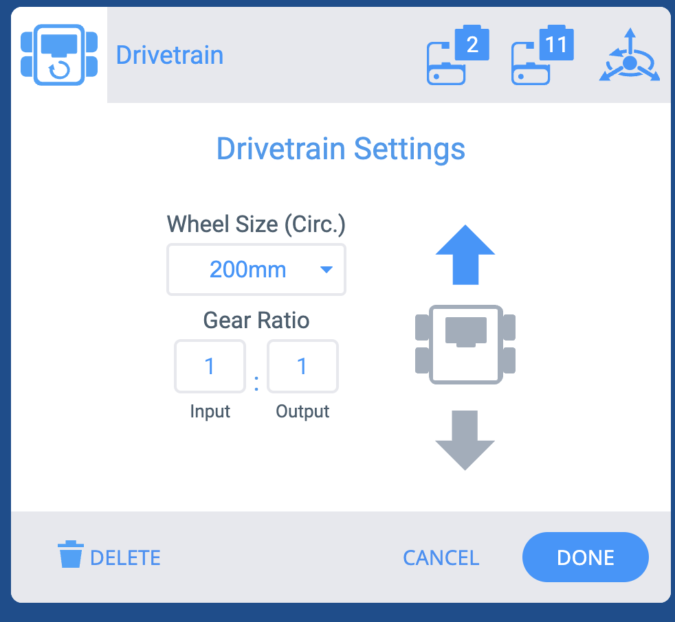

Hello. To help troubleshooting:
  • Can we see your configured devices?
  • Are your motors in the right ports?
  • Is the direction of the drivetrain configured correctly?
Sardorbek_Omonkulov,
  1. I have only configured my drivetrain on to my controller.
  2. I am pretty sure I have connected it to the right ports, but I will check again.
  3. Yes, it is configured correctly.
Oh sorry, you want to switch the joysticks?
I have not tried this, but I found this Vex article on custom joystick configuration:
You can do something like this:
(To go forward, each line a seperate event)
LeftMotor velocity (controller c position, percent); LeftMotor spin forward
RightMotor velocity (controller c position, percent): RightMotor spin forward
(To turn, each line is a seperate event)
LeftMotor velocity (controller b position, percent); LeftMotor spin forward
RightMotor velocity (controller b positionn percent); RighMotor spin reverse
