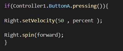

Our team’s robot can drive, it just goes fast and is difficult to control. I made code that told the robot to slow down from 75% max velocity to 40% max velocity. (I was in a rush, it is in block coding so I don’t have the correct syntax. This code kept making it so that the drivetrain would only go forwards no matter the direction of the joystick.
If A pressed
set max drivetrain velocity 40%
Can you send me a pic so I can detect the error

i think you need to do a block that says go forwards or backwards as well, all that you did was tell the code that when you refer to the drive train, it should go at 40% power. (that is how it is in text code, and i think it is the same for block code)
I am not following you. It moves around like normal without this block of code. Can I have a picture of what you mean, please?
this is code in text, you have the if statement above, one line seting the velocity, and the next telling it to spin forwards.
What is ‘Right’?

G I think you might need a if else statement with the else being stop ___
that is the motor name
oh, sorry, i re read the post, and what i was saying doesnt help, sorry
