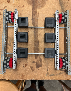

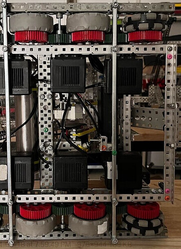

Our Drivetrain drifts left for no apparent issue. We have tested many thing such as testing all motors, testing watts used on each motor, checking overall friction on each side, checked for bent axles, checked program, checked for scrap metal in gears. None of this worked and the Drive still drifted left. I will take a video on friday and post it but here are pictures of our drive.
The only thing I can think of is check the alignment of both of your sides of your drive. Maybe on of your cross drive support bars is miss aligned? In other words make sure that the drive is properly squared, which does look like you did but I’d check anyways.

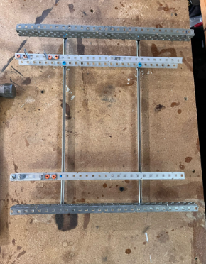

Everything should be square, this is a picture from when we started building it

My guess is that the larger radius of the omni-wheels compared to the traction wheels, which lifts the robot up a tiny bit, just enough to keep the traction wheels from touching the ground.
Is there any resistance when you try to move the robot left and right manually? If so, something might be wrong with your traction wheels.

We put the tape there to test if both sides spun together, they don’t right side is faster. All four wheels make contact with the ground on both sides.
Pull the shafts out of the motors and spin both sides with your hands. Do you feel significantly more resistance on the slower side?
If so, try to find the problem shaft(s). I spent 3 hours just tweaking shaft cuts, spacer and washer amounts, and bearings. The result was a very low-friction intake.
These horizontal bracing could be the problem I assume. sometimes the two wheel systems are still parallel, but those bracings aren’t perfectly perpendicular. The same problem is happening to our robot :smiling_face_with_tear: .

could be a programming issue asusming your testing of DT friction, motors wattage and motors actually being connected to the axels. also little FYI having 2 HS shafts as your cross braces isnt great. they only have 1 point of connections not 2 which allows for alot more shifiting than a pice of cchanel whcih isanchored to each other pice in 2 places.

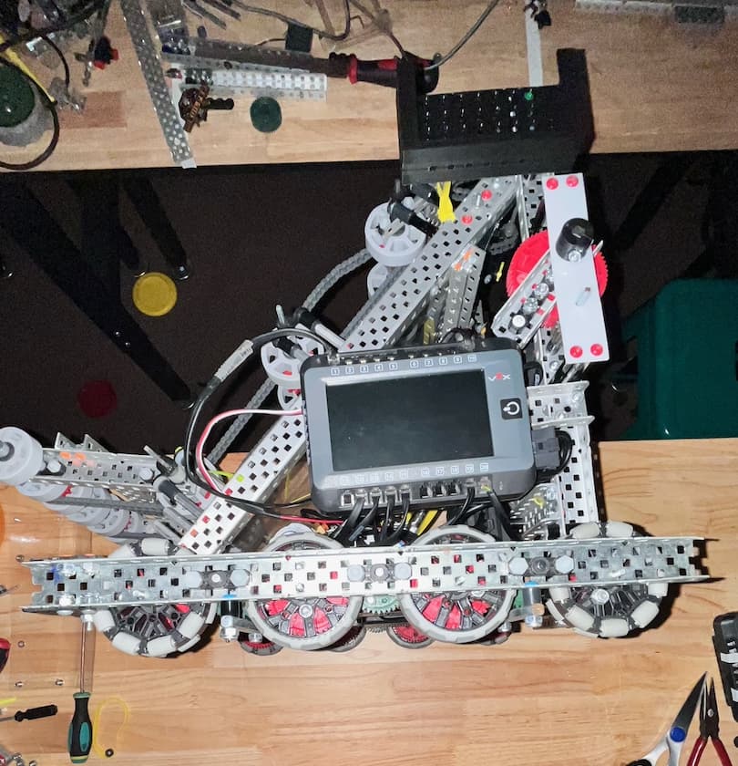

So i did notice in the videos that the back traction wheel on the right side of your robot seems to be not level almost bouncing up and down. Maybe check that
Are your motors properly seated, from the photo the top set of motors do not appear to be.
