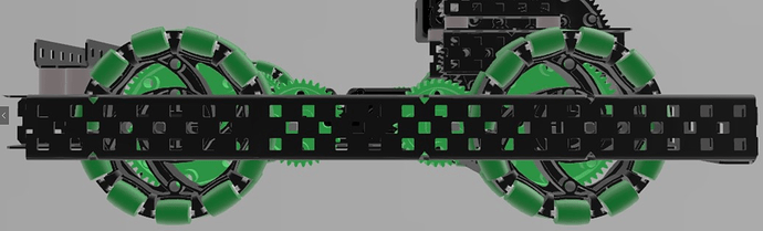

friction is negligible. i never remember the friction becoming a problem. ever. u have a point about chain snapping. That i’ve seen plenty of. But that only occurs when you make the chain SUPER tight. Just add another chain link if it’s too tight
friction, is definitely not negligible, especially on a drive. also, what advantage is there to chaining it all together?
instead of each wheel providing the power of one motor, each wheel can now have the power of two motors. Also makes sure they’re both spinning at the same speed. For programming at least it’s nice to know both wheels on one side are spinning at same rate
no, both wheels share the power of 2 motors. due to friction, each wheel will actually be slightly weaker than with my method.

one issue all of you have neglected is weight distribution. say your bot is heavier at the back and lighter in the front. if you have four motors each driving a wheel and they are not connected, the strain on the back motors is going to be heavier than that on the front ones. That’s the reason we connect the front and back wheels.
EDIT:for Mecanum drives this would result in not strafing straight but there’s not much to do except to slow the lighter side motors down.
The vertically placed motor is for moving the front wheels?

Both motors move both wheels because you’d chain all three sprockets together
