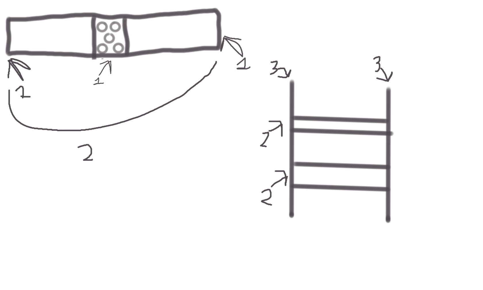

i always made a 2·20 drive train in the beginning and them custom built my crap on it then at the end cut it down 2 a 2by16 or even a 2by14 because its a lot easier to switch out smaller than bigger my advice ud be use 4 omni conect them wth chain and do a sprocket meckanical advantage in the back of 3 make sure u check the omni wheels constantly cous they may strip to stop this pin a 36 tooth gear 2 it
your supports should look somthin like this:drvetrn%20idr
one is that little black piece with to pegs coming out each end 2 is made up of those and a 2by12 or a 2by10
3 is a 2by20
edit:(the meckanical advantage is for speed)
