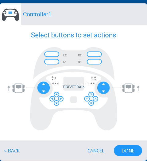

Using VEXCode and the controller configuration, you can configure it for tank or arcade.
Here’s the relevant KB article
Oh, got it, is this how you’d do it?

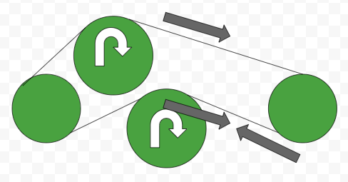

Being new to programming with VEX block code, I’ve come across the same problem many times in the past year. I still haven’t figured out how to program the joysticks for anything other than the drivetrain. Just this morning actually, this problem came up again when I tried to change my program due to a motor being outside the drive chain. My problem was that the two motors opposed each other and tried to rip the chain apart, so I tried to program one motor to turn backwards but found no way of doing that.
Here is a quick sketch of my drivetrain if you care to understand:
Upon seeing this mess of an image I should probably rethink the drive, but for learning’s sake, does anyone know of a fix to the opposing motor problem, and also to my joystick programming problem?
And to answer the original thread question - I’ve gotten this far with only using the drivetrain feature, so it’s definitely doable if you don’t over complicate things like I’m trying to do here.
You should be able to reverse one of the motors when you set the drivetrain up.
Blocks programming hits the 80 / 20 rule where 80% of the programs can be created using the basic blocks applications and 20% fall outside if its capabilities.
  • The easiest way would be to adjust your physical drive chain path so that both motors turn the same direction.
  • Next option would be to remove the drivetrain and manually program your chassis control with motor groups. The negative being that you lose the features of the Drivetrain (IE: The inertial sensor in autonomous).
  • Finally you can switch to VEXcode Pro and customize your own Drivetrain. The example below is code for a six motor drivetrain with an inertial sensor. Drivetrains in code can take advantage of motor groups. Perhaps that is a feature Vex can add to blocks in the future. This gives you the options that you need but can be more difficult to create and maintain.
