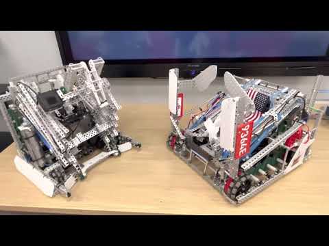

Here are two videos of transmissions:
This video uses a motor to shift between gears, but this can be easily done with pneumatics.
A pto is different, and it uses cylinders to shift motor power between two different subsystems. This can be done in a variety of methods. Below is a simple example of pto:
let me know if you have questions
also look at 8:28 for the other pto design
There’s lots of good info and pictures of a very competitive old robot with a pneumatic shifter here:
