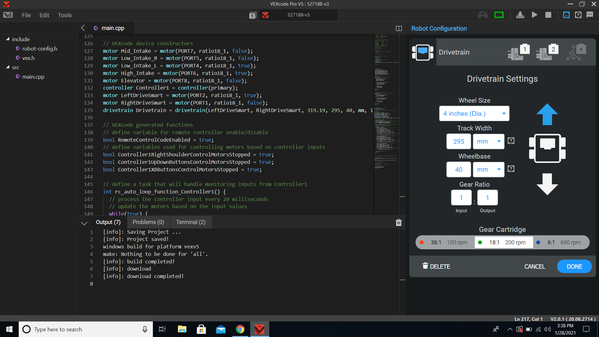

Hello, I have set up a drivetrain in my code, but when I run the program and try to steer/drive my robot, it doesn’t drive. All the other motors work. The drivetrain is 2 motors, with no servos. The left motor is port 1, and the right motor is port 2.

Can anybody give me information on why the Drivetrain isn’t working? I have it set up as left-stick driving in the same controller as the rest of the motors. I am new to coding, so it could just be a simple mistake.
Here’s a photo of the drivetrain:
Screenshot (3)
If you have any suggestions that might work, please tell me them, as we have a competition tomorrow, and we won’t be able to have a pre-game code without this.
Can I see how you set up your controller? It’s most likely due to the fact that you deleted the robot-config.cpp file. Also, it seems that you never have any of the callbacks for a tournament, so it wouldn’t work anyways. Like my earlier suggestion, just remake the code under the competition template.

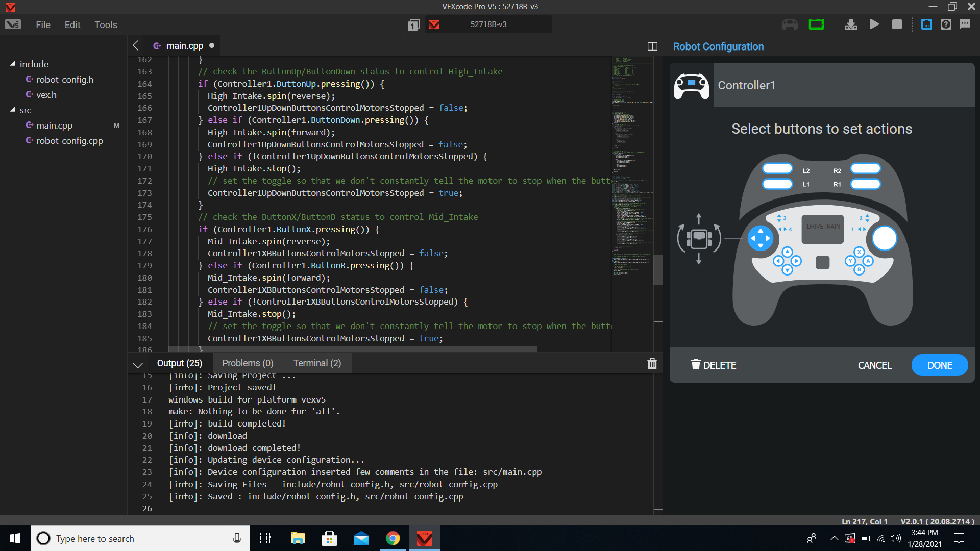

I deleted the robot-config.ccp file and pasted it into this one, since, for some reason, the robot wasn’t including it, but the code would count things as an error if it had simply been copied and pas. ted while the robot.ccp file was still there, or if it wasn’t copied and pasted. The reason no other motors are set up to the controller is because multiple motors are binded to single buttons in the code, making it useless (I believe) To bind anything other than the drivetrain to the controller. Screenshot (4)
(The robot-config-ccp file keeps redownloading for some reason at times, so I have to make sure to delete it before uploading it, or else I’ll get a compiler error)
The robot config.cpp basically determines how your program will function if using the drivtrain object. Like I said, you should just recreate your program in the competition template. Alternatively, if this worked in vexcode v5 text(non pro), just stick to that.
I just added the motors, controller, and drivetrain, and
A) There’s quite a bit of errors
B) After I fixed the errors, the drivetrain still wouldn’t drive
Can you post your updated code?
Also, your current program would violate rule R28, as it says that for programming, you should use the competition template or a functional alternative. Based on what you see, the callbacks aren’t ever set up. Therefore, your program wouldn’t work in a competition.
@Sylvie would I be correct in the assumption that @Pyro52718B would violate R28?
No? Absolutely not. The code won’t work, but it doesn’t break any rules. You’d have to try very hard to break the rules regarding programming and auton.
Don’t use drivetrain. Drivetrain is bad. Instead, add in all of your drive motors individually. And yes, use the premade competition template that vexcode provides.
