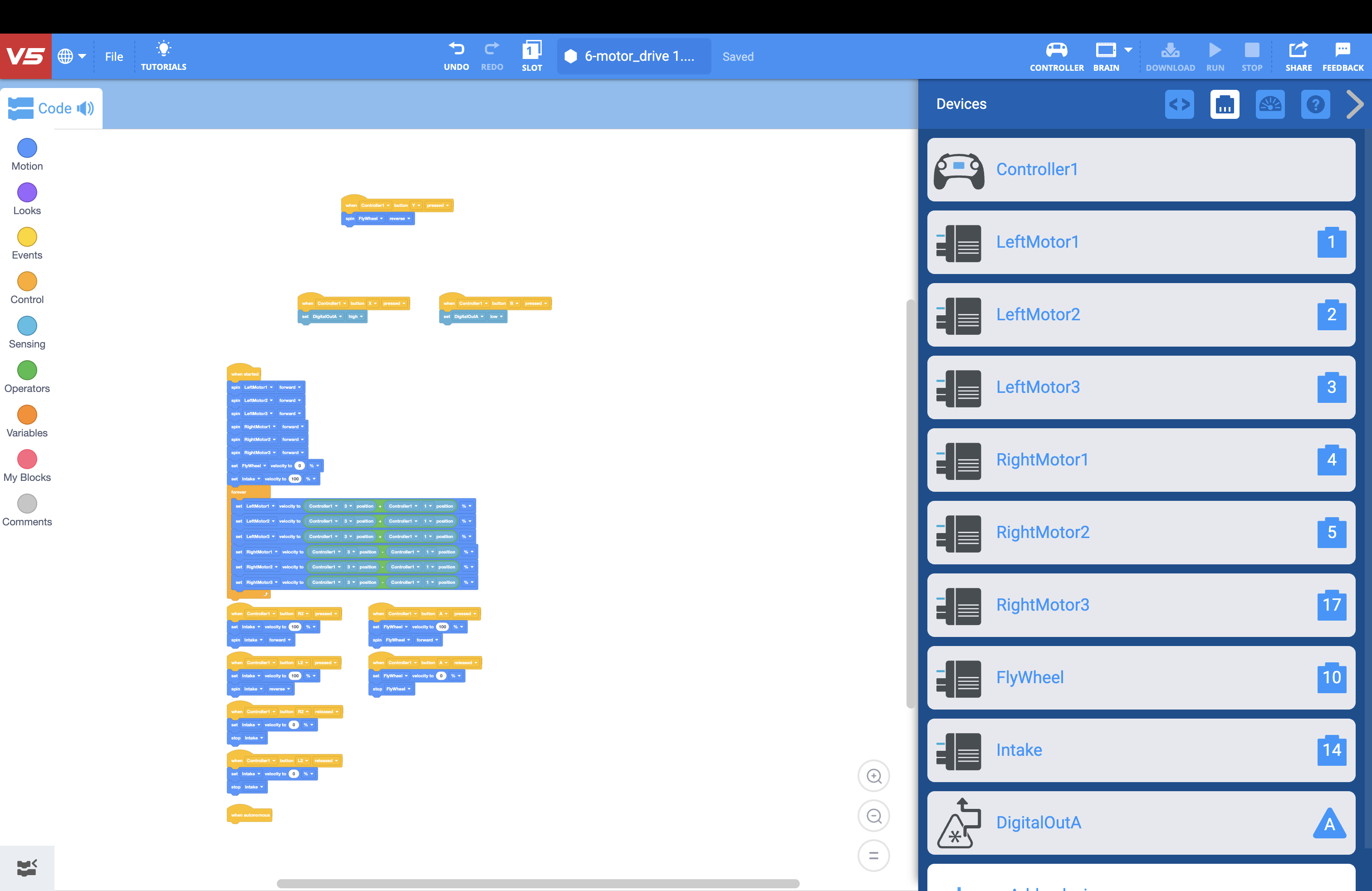

Could you send a picture of your code? I don’t understand what the problem could be here, but I need a visual picture of the code so I can see what’s wrong.
Recommendations: Put the drive code onto another When Started instead of how you set it up. Check the code where it can be possibly one part that overrides the original drive code, so check where the intake spinning code is and see if it does anything in the drive code.

Solved! We converted the code to C++, everything works fine now. Direct copy + paste, but its fixed. Not sure exactly what caused it but I do know the fix.

It’s back because we lost our code, but were able to find an old version of it, which unfortunately still has the bug, and changing everything to text doesn’t work this time. So now I have to find a new solution. (This was after our entire program just stopped working out of the blue)
Update #2: I fixed the issue again; transferring from block code to text code didn’t work the 2nd time, so we copy + pasted everything into a new program and set up the same thing (again, purely same code but different program, just with C++) and it works just fine now. So if anyone else has the same issue and converting to text doesn’t work, try moving to a different program.

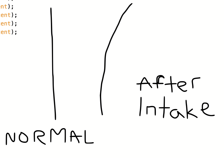

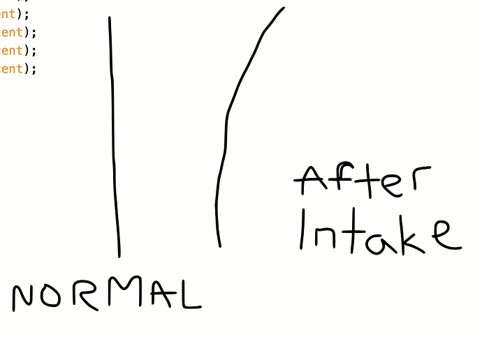

When I started the program and moved the joystick forward, the drivetrain would drive straight forward. I would then spin the intake motor in any direction, and then do the same action of driving the joystick forward, only this time it would curve slightly to the right (only while driving; seemed like a motor not being powered, even though they all were). It does this broken driving every time you try to drive it while in the same program as when you spun the intake. Exiting and reopening the program made the robot drive straight again, and spinning the intake would break it again.
