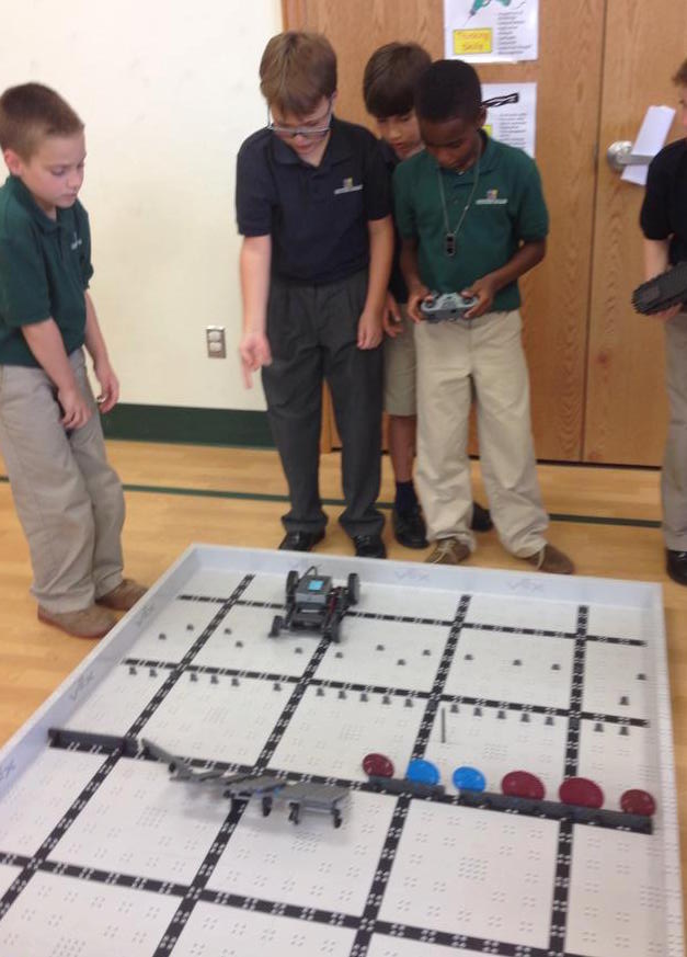

Once you have the drivetrains built you are ready to run them through a series of tests. The following tests: Tug of War, Drag Race, Catch the Other Robot (round track), Obstacle Course, Mine Field. Ideally each test would show the strengths of a different drivetrain.

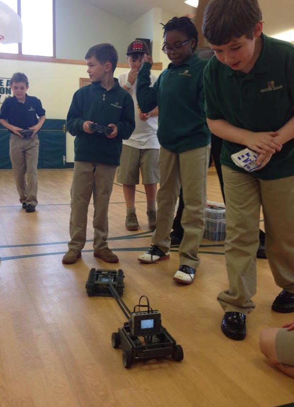

Tug of War: Connect two robots together back to back with Vex IQ chain or tank tread. On GO the robots pull in opposite directions. The first robot to pull past a predetermined finish line wins. Set the finish line so that one robot must pull the other about 2 ft or 1/2 meter. Use a bracket ranking system to determine which robot is the best.

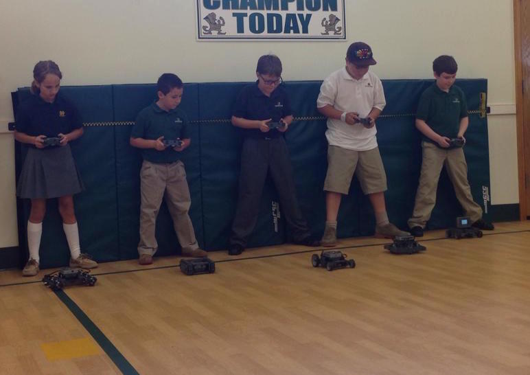

Drag Race: Line up all robots behind a starting line facing the same direction. On GO all robots drive forward as fast as they can in a straight line to the finish line. Set the finish line 10 or 15 feet (~4 meters) from the starting line.
Catch the Other Robot: This is a round track race with 2 robots. They start directly opposite to each other on track and go around in the same direction. The robot that can catch the other robot wins. Use a bracket ranking system to determine which robot is best. Results will vary base on driver skill, especially for the slide drive.
Obstacle Course: Setup a course that requires robot to go around, over, under, or move objects to get through. Same course for all robots, so you must make something that can be reset. We used a Vex IQ field with different IQ parts stuck in the holes. Keep track of the best time. Results will vary base on driver skill.

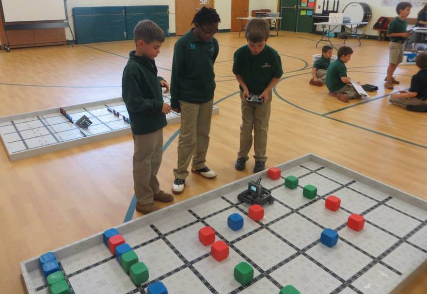

Mine Field: Setup a course that robot must get through without bumping into anything. We used a field for this too and placed blocks so that it progressively harder to maneuver past them. Track how far each robot gets before it touches a block, and how long it takes to get to the end, if they get that far. Results may vary based on driver skill, especially for the slide drive. Note, that robots will a smaller foot print also have an advantage.

    Here are some pictures of the challenges.

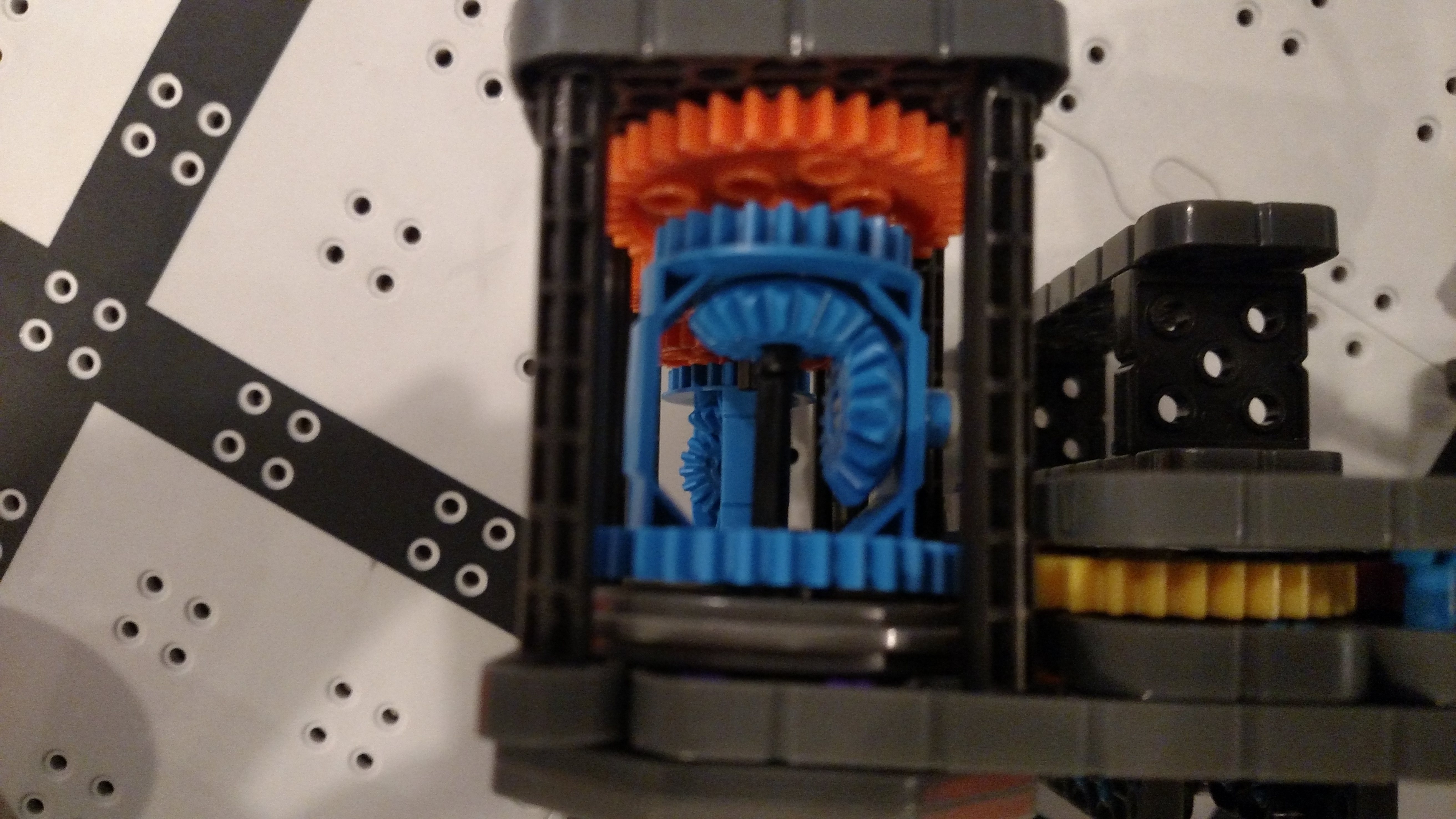

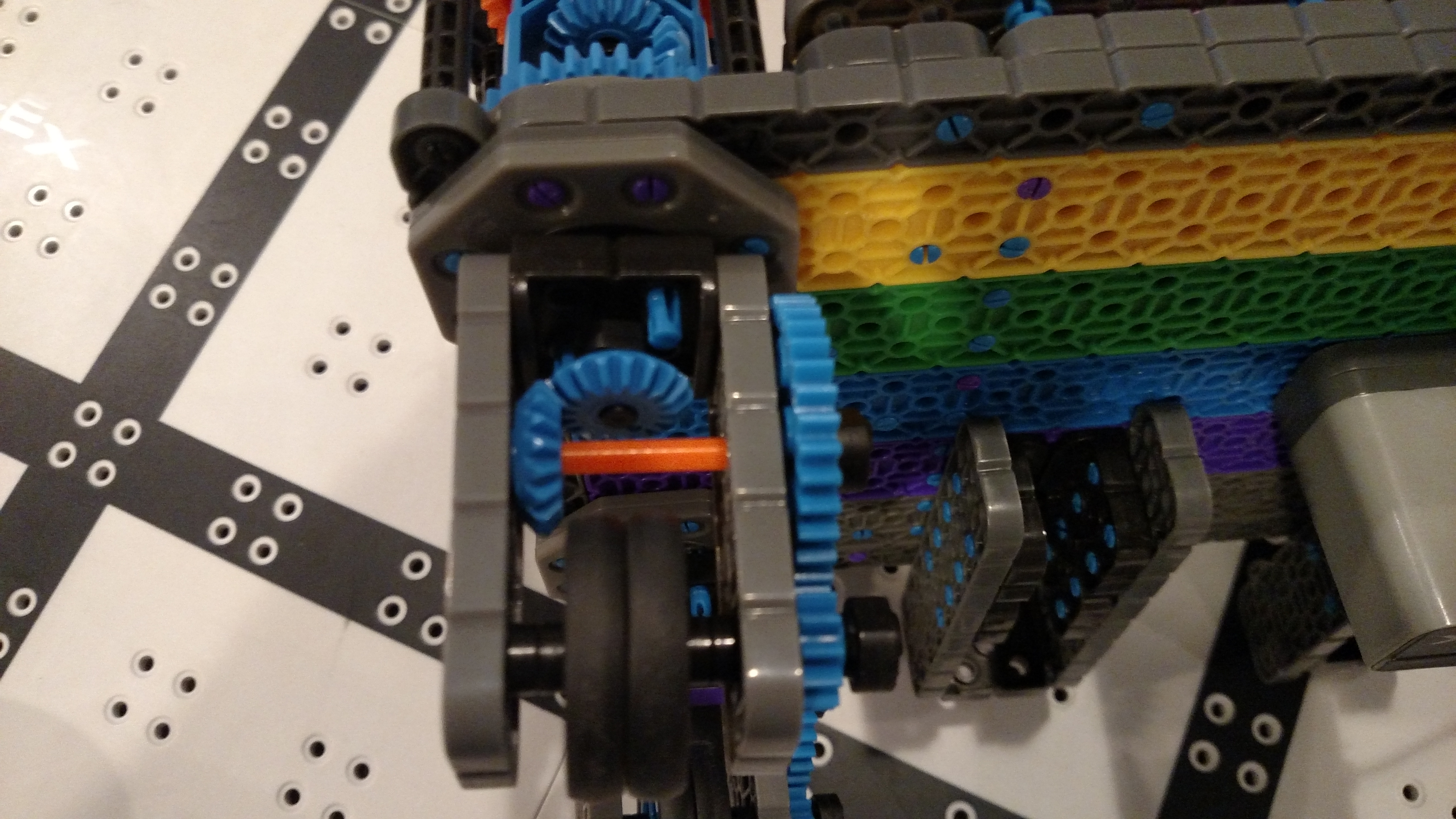

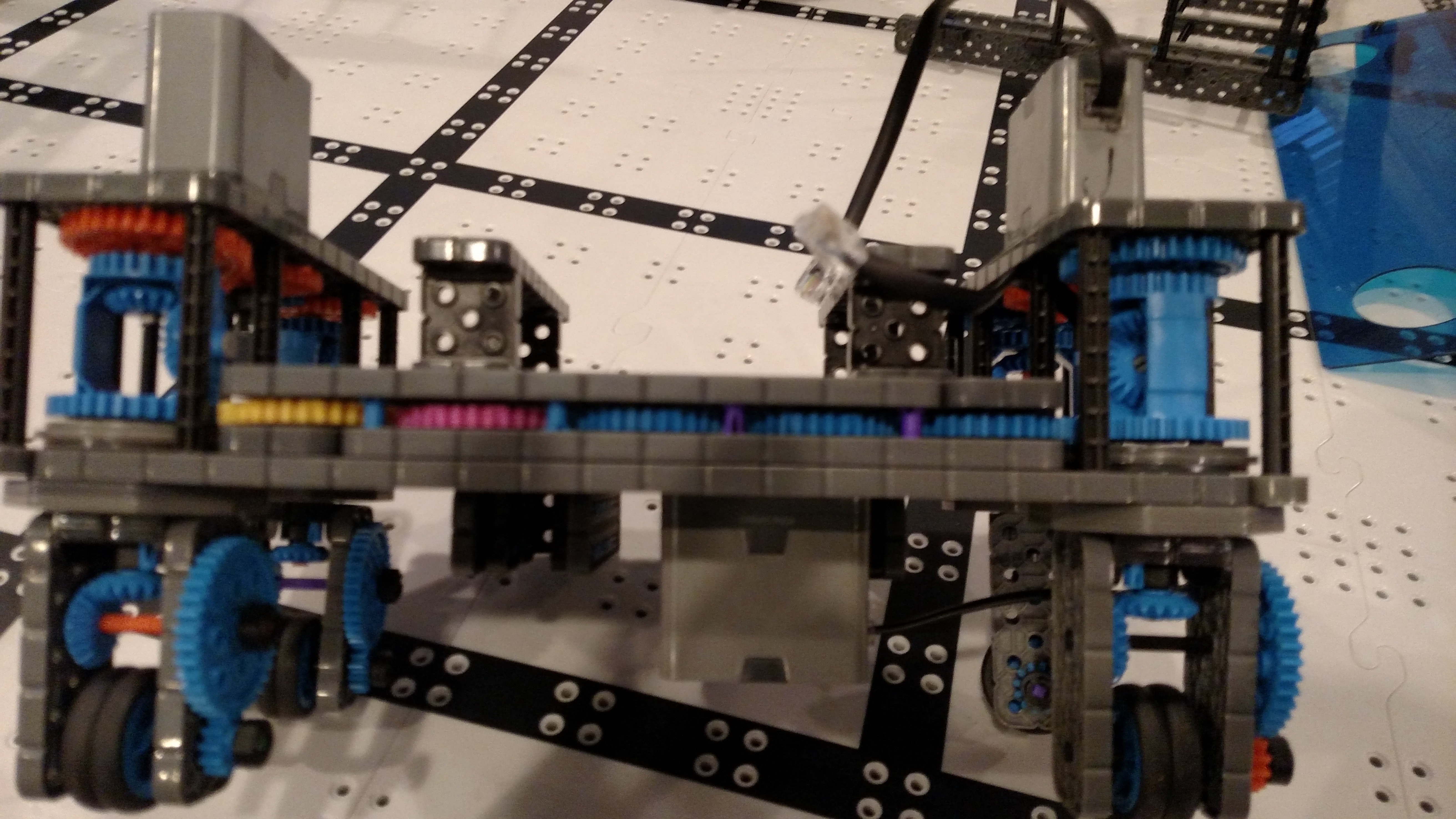

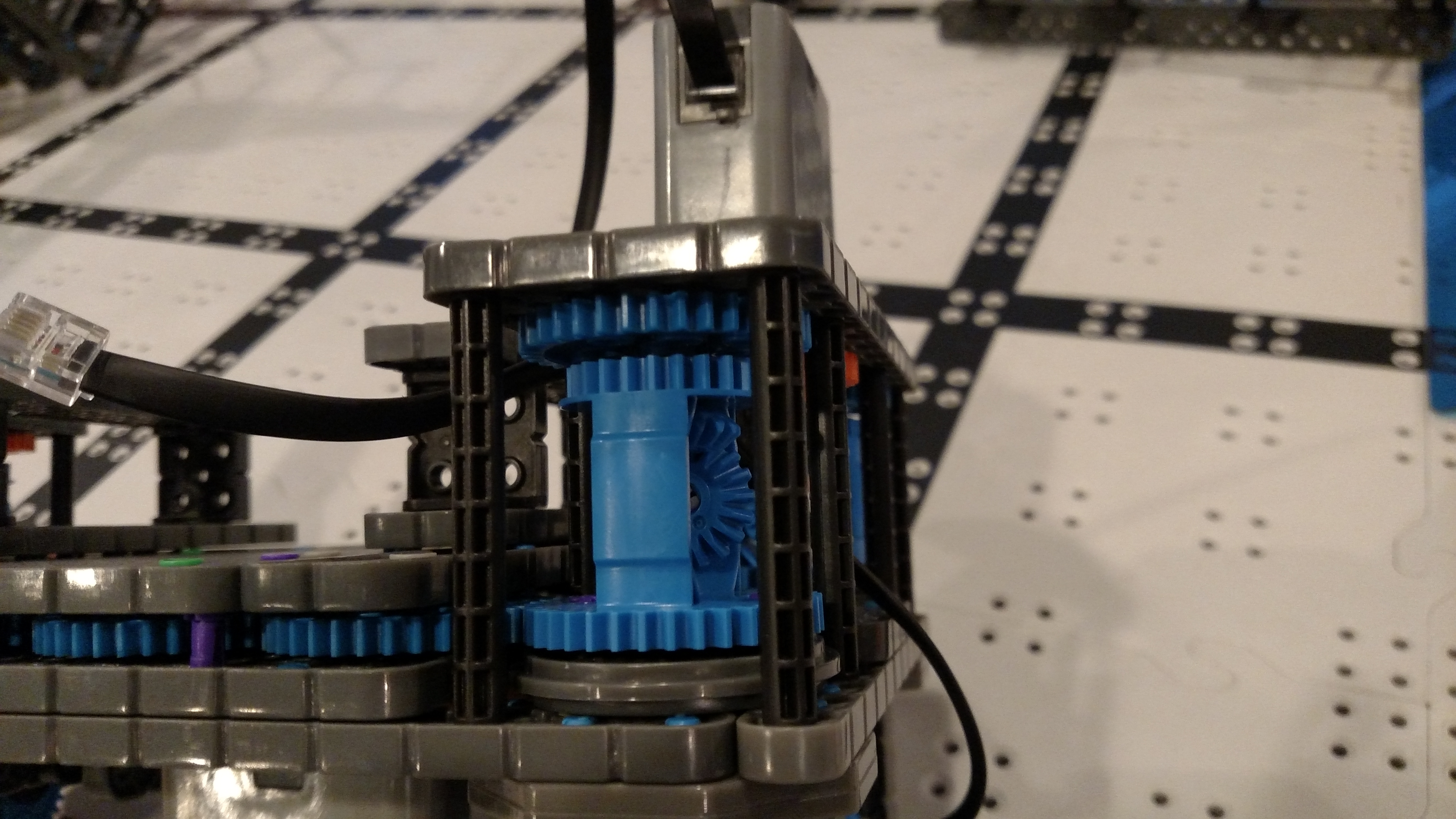

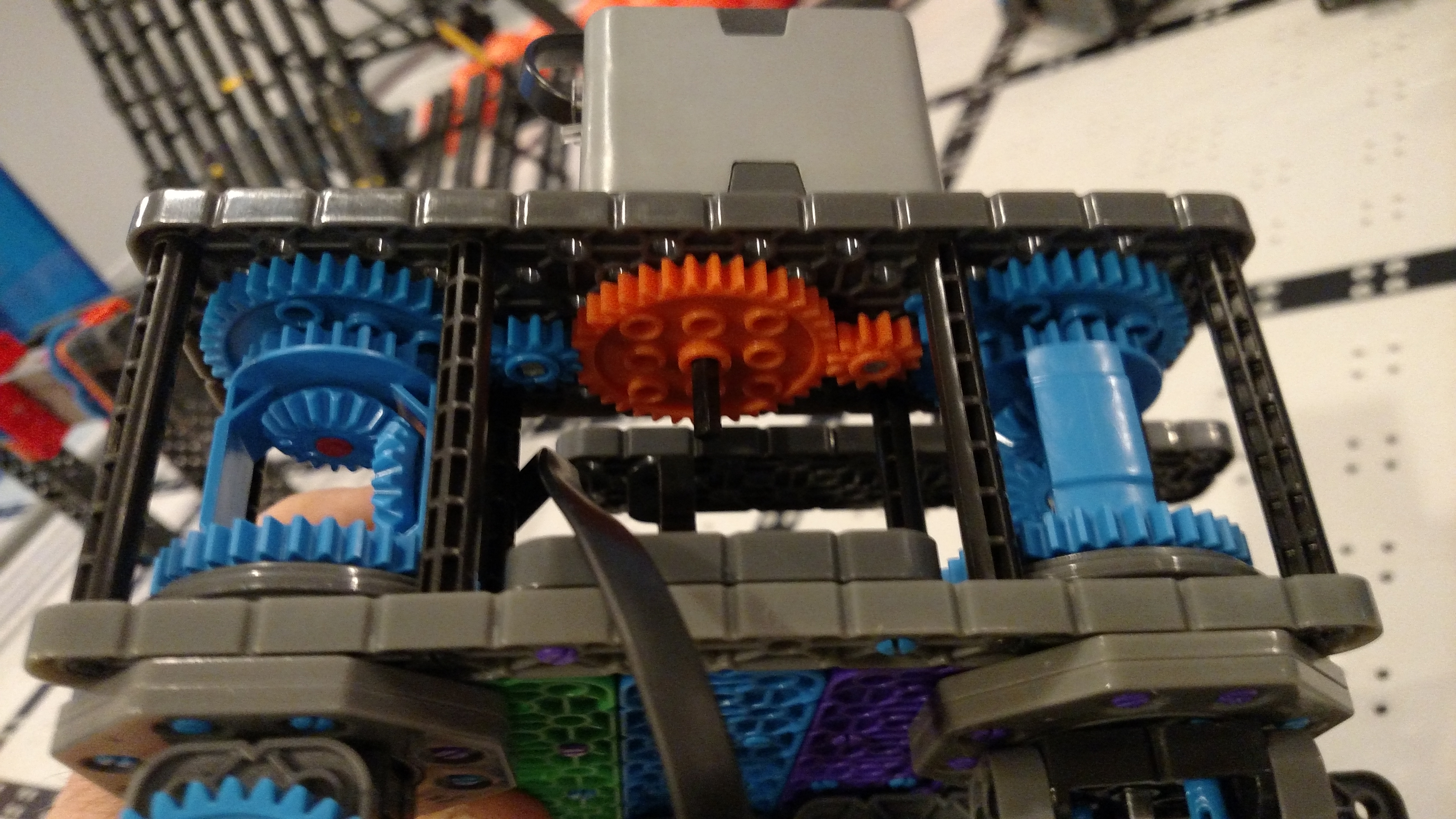

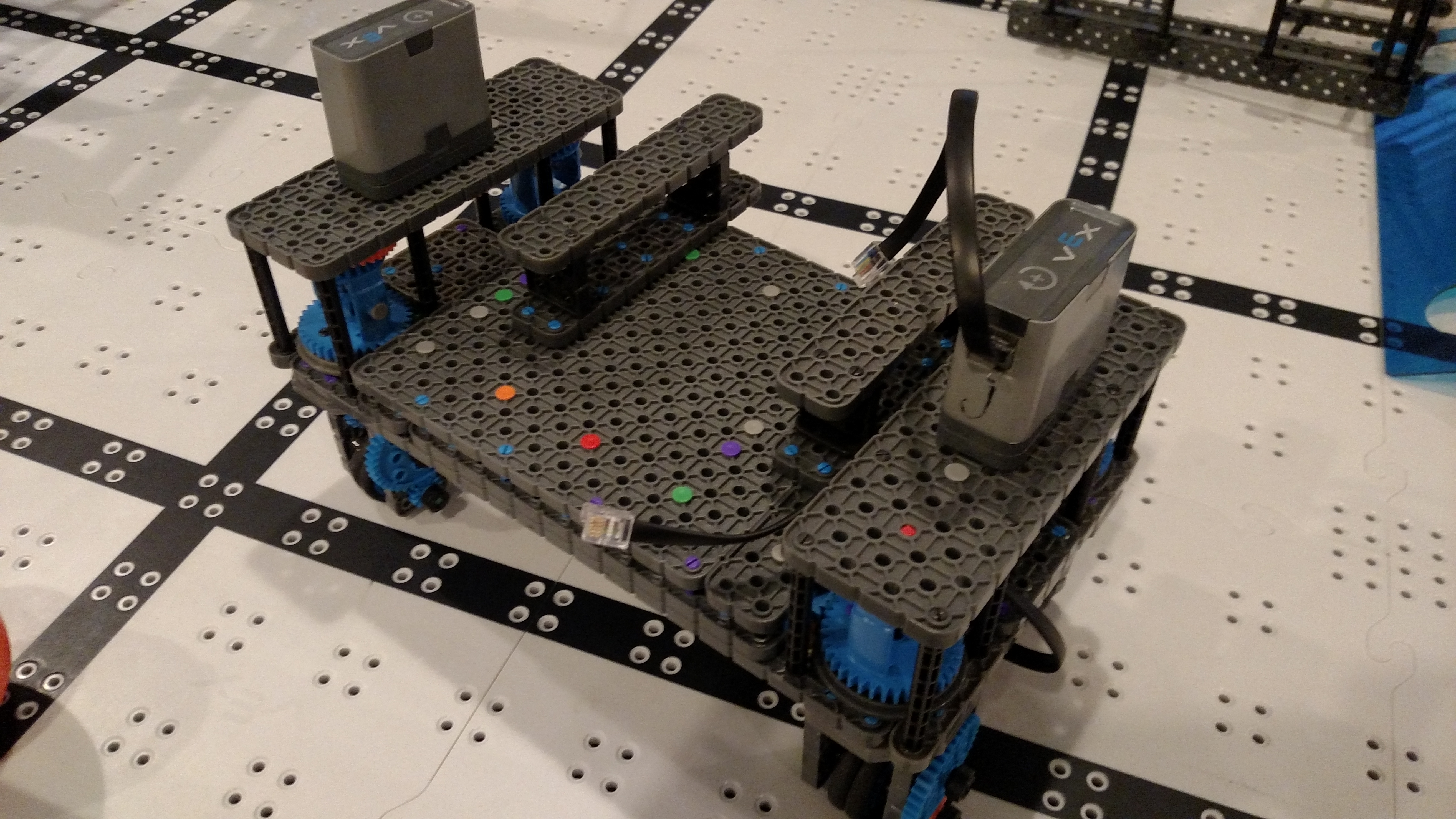

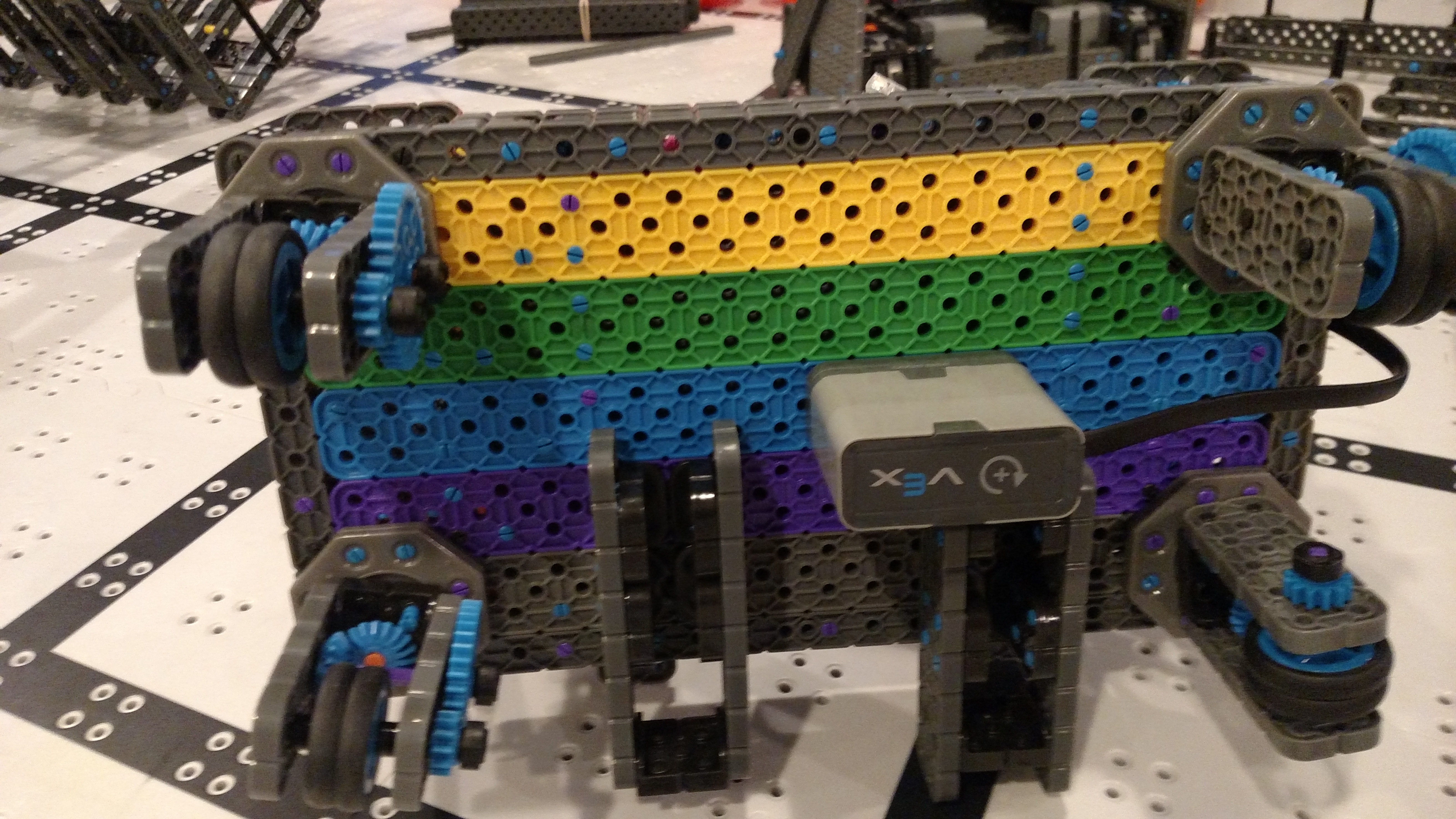

    The crab drive was quite difficult in VexIQ . This one works: https://www.youtube.com/watch?v=m-zREfLMo2I but would not be practical for a competition robot. It uses 5 motors just for the drivetrain.
    Below are some pictures of a later version, using turntables and the differential part that they now sell. It reduced the number of motors to three. This one sort of worked, but it was not promising, and interest waned.
    All in all, I would not recommend attempting to build a crab drive as part of a lesson or group project. This is a good “advance study” project for someone who is really into it and can work on their own.
