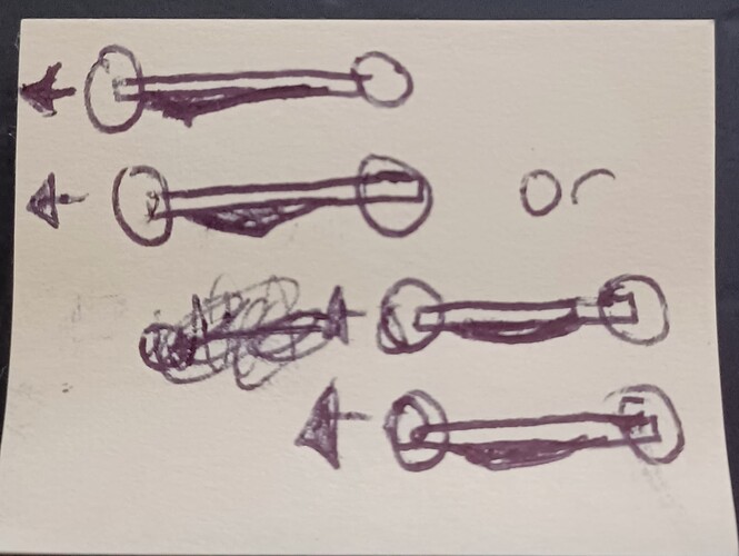

I’m running a 480rpm on 3.25” omni with gears 60 48 48 48 60. Originally I planned to put a 3” flex on the middle 48tooth gear but later realized it is too big (too close to the ground) and didn’t have great effect when going over the barrier. Does anyone have good suggestions about what I should put on the middle 48 tooth gear to optimize the ability to go over the barrier?

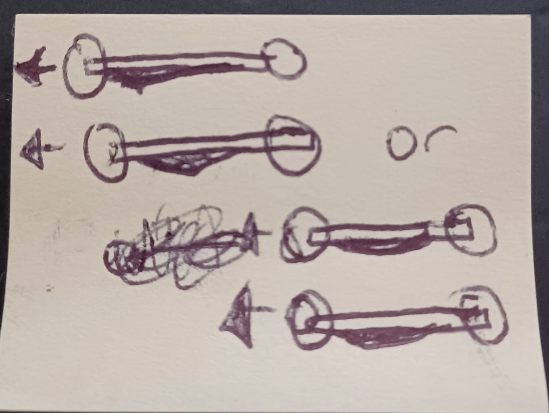

I haven’t tried this, but you could add a triangle/rounded sled underneath the robot that would help “slide” the robot across the barrier and tip it in a favorable direction
Here’s a janky sketch:
