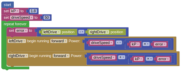

Hi! My students and I are having trouble with getting the mimic simulation in RMS to drive straight. Their code is written correctly, but the actual simulation tends to veer to one side. Is there anything that can be done to fix this? We’re coding using Blockly and have built the standard drivetrain robot in Mimic.
The code is probably not drift-correcting (i.e. you are most likely just sending speed commands to the motors). RMS is a real-world physics simulation; if you’d like something easier and more repeatable I’d suggest Vex VR. Alternatively, you can program your robot to correct for drift using a simple P-loop, or, at a higher level, motion profiling or odometry.

In this case, I would set the wheel speed to a constant plus a multiple of the error between the two sides of the drive (P - proportional - the difference in input speed is proportional to the error). Here’s some pseudocode if that didn’t make much sense:
kP = 1.8; //constant proportional factor
driveSpeed = 50; //average drive speed
while(1) {
  error = leftDrive - rightDrive;
  leftDrive.spin(driveSpeed- (kP * error)); //if the drive is veering left, slow down the left side
  rightDrive.spin(driveSpeed + (kP*error)); //if the drive is veering right, slow down the right side
This works because the more the robot has veered, the harder it will try to correct itself, and once it gets closer to straight, it doesn’t try as hard.
EDIT: While it’s essentially the same thing, here is the blockly version of the code:
