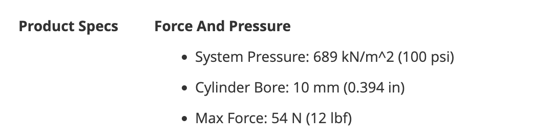

Basically we have a new 50mm Cylinder that needs to fold inward a bit in order to start in limits. When finding a solution, we noticed it couldn’t push the rubber band forward.

Is it possible to verify the force of the cylinder in reality? As in verifying the we get ≈ 12 foot pounds of force.
