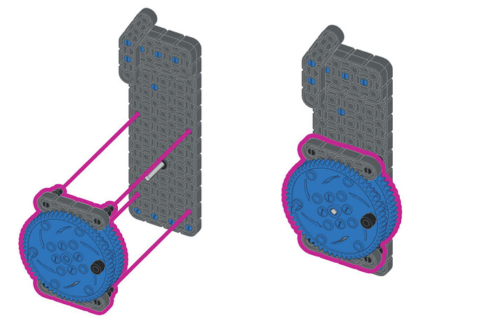

We are having trouble with the gear popping out any help guys
In the Vex IQ VEX IQ Builds - Fling they use double gears and a 1x to lock it in place.
Edit: Adding reference link:
https://content.vexrobotics.com/docs/21-22/pitching-in/Fling-BI-Rev2.pdf#page=29
In addition to what @Hudsonville_Robotics said, I would suggest getting rid of the orange spacer between the gear and the beam to make it flush with the beam, providing the most support for your catapult. Also, make your the teeth on the gears are aligned and not skipped.
