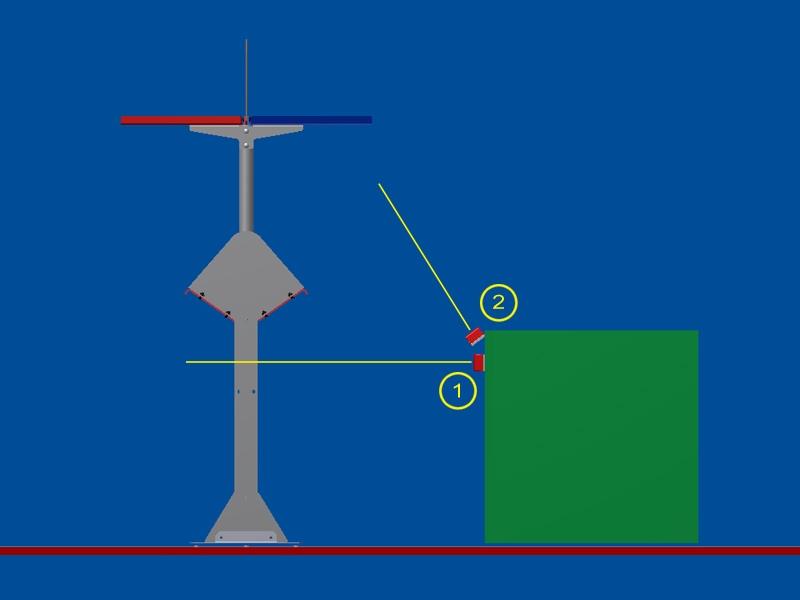

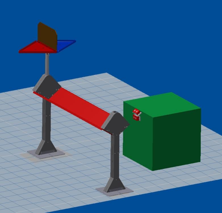

I’m having trouble seeing how this actually works in practice. Lets look at the geometry.
[ATTACH]7383[/ATTACH]
[ATTACH]7381[/ATTACH]
The green square represents a 15" cube (the robot), there are two ultrasonic sensors on the front face, one points directly forwards, the other upwards at an angle.
The forward facing sensor (1) will not detect the face of the trough which is angled down, any waves hitting it will be reflected towards the floor rather than back towards the robot. They may be able to detect the stanchion but it’s very narrow and will not reflect much. The angled sensor (2) will not detect anything when the robot is in this position.

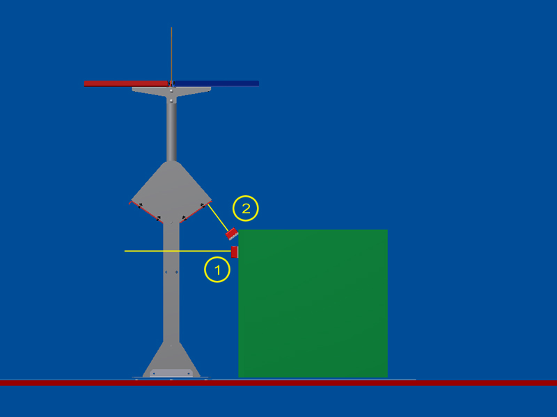

[ATTACH]7382[/ATTACH]
Now the robot is much closer, the forward sensor still is not able to detect the trough, the angled sensor now will see the trough wall about 6 inches away. This sensors output will change very quickly from detecting nothing (-1) to finding the trough.
