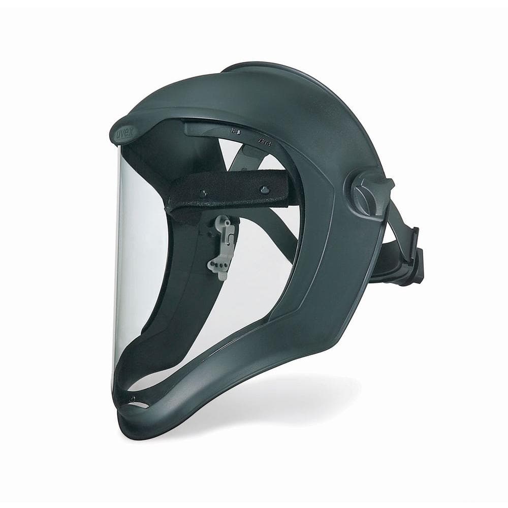

There is a universe of “over prescription” safety glasses awaiting to help you. I know, because I need them, too.
https://www.amazon.com/s/?ie=UTF8&keywords=over-prescription+safety+glasses&tag=googhydr-20&index=aps&hvadid=177830535496&hvpos=1t4&hvnetw=g&hvrand=10029171892743168462&hvpone=&hvptwo=&hvqmt=e&hvdev=c&hvdvcmdl=&hvlocint=&hvlocphy=9007871&hvtargid=kwd-51433948831&ref=pd_sl_4azdfdy9xn_e
If that’s not good enough, you can probably use a full face shield. https://www.amazon.com/3M-90028-Face-Shield/dp/B000BO6RIE/ref=sr_1_7?ie=UTF8&qid=1488934952&sr=8-7&keywords=face+shield
All of these sorts of things are available at places like Lowes or Home Depot, etc.
Hadn’t thought of that before, I’ll definitely look into that.
Also,
now I’m tempted to make an entire helmet, like a Mjolnir helmet. With lights. And a HUD.
Just be sure you can still breathe after decorating it with all your LEDs and gadgets. Nobody wants a faceplant on the field, face shield or no.
https://www.amazon.com/HONEYWELL-S8500-Bionic-Shield-Suspension/dp/B001VXXUWK/ref=sr_1_1?ie=UTF8&qid=1488936333&sr=8-1&keywords=bionic+face+shield
