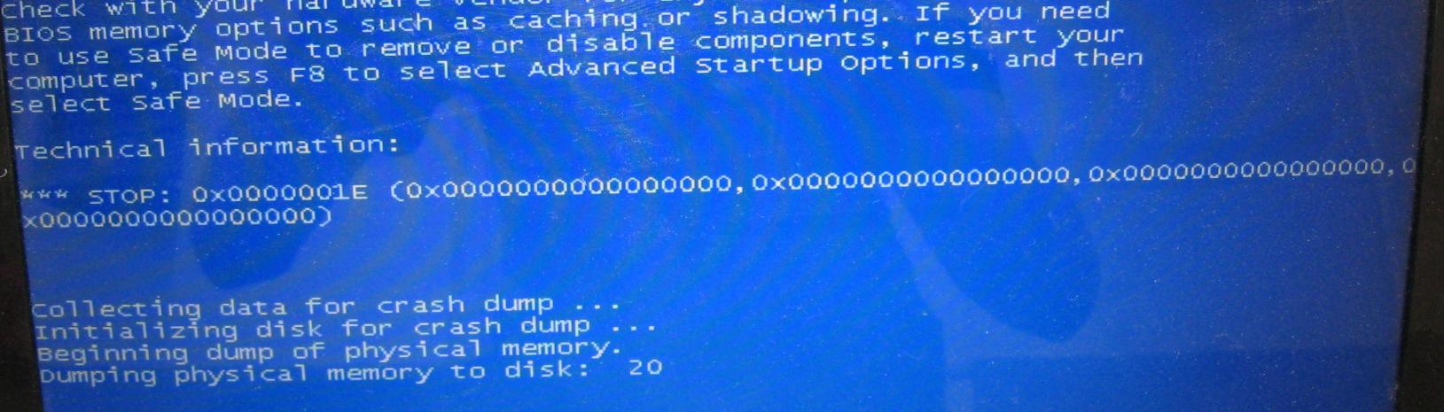

We have updated everything, reinstalled and followed everyones suggestion. We will get the picture of the BSOD after we finish preparing for the world competition.

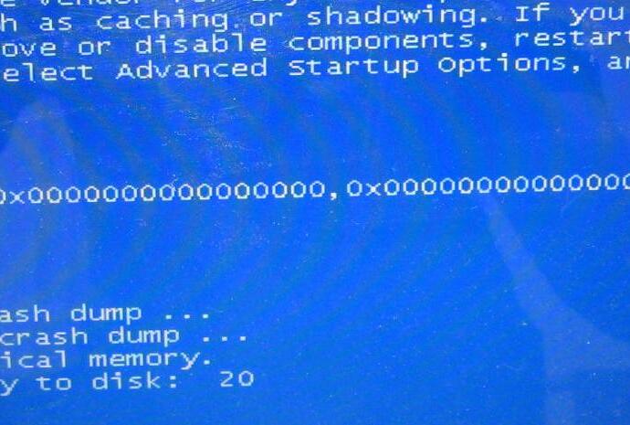

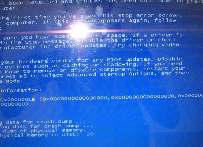

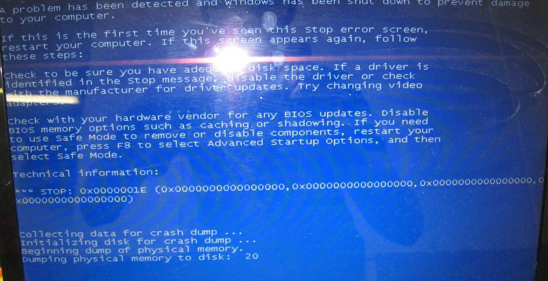

Do you have a picture of the top of the BSOD, as that is where the more useful information is. By any chance does it say “Driver IRL NOT LESS BUT EQUAL” or something similar?
OK, you’re BSOD’s look different than the ones my computer gives me. From what I can see, it is not related to any drivers, so it is most likely not the prolific serial adapter. I’m not really sure where to go from here except contact EasyC support, but I have a feeling that you have already done that.
