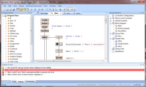

Hi, a question arose in the weekly Vex team meeting: Why are the words ‘true’ and ‘false’ highlighted as if to indicate that they are keywords? E.g., while (true) {…}. The result of compiling such code is an error. Also, do any headers that are installed with EasyC contain macros or variables for these constant values?

Thanks for the quick response. I appreciate the tip on the use of the #define statements, and will make use of them. However, my main question, re-phrased, is essentially this: If neither true or false are C keywords (and in fact without the #define statements that you recommend are compilation errors) why do they appear in a blue font in EasyC 4 for Cortex. Using a very simple program I wrote as a guide, the only other words that seem to be blue rather than black are C keywords, like ‘if’, ‘while’ and ‘continue’.

Can you send me a screen shot, I’m not sure where you are seeing this.
Here it is.
-Brian
I now understand what you mean, honstly I understand how true and false ended up as keywords. This seems to be a “feature” (broken) and I see how it could cause confusion. Honestly I don’t see why we couldn’t add true and false to the definitions in the API. Look for it in the next version. :slight_smile:
