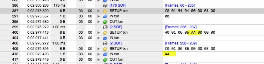

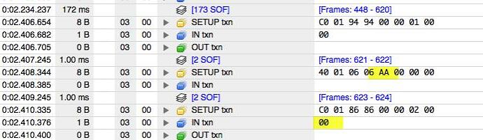

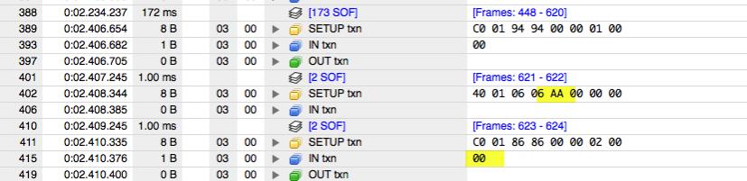

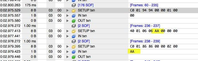

It looks like you have multiple versions of the prolific driver loaded. Have you recently updated the development software? Are you on EasyC or ROBOTC? (edit: OK, I see both)
These problems can be hard to debug, all I can tell you is the following.
I have a ROBOTC V3.04 installation running under Windows 7 pro 64 bit, the driver I have installed is version 3.3.17.203 which I downloaded from the prolific web site, however, this was back in October last year. Under programs and features it shows as PL-2303 USB to serial version 1.4.17, see if there are any other PL-2303 installations.
I have seen error 10 before but in my case it was a defective programming cable, have you tested the cables on other hardware or do you have a known working cable you can try.
I would try and uninstall all versions of the driver and then start again.
What Driver is Loading when the Vex USB-to-Ser cable is plugged into the Laptop?? ( Device Manager–>Ports ( COM & LPT )–> Prolific USB to Serial, Double Click and then Click the “Driver” Tab, if it is there.
Your Newest Driver appears to be, DrvDate - 04/02/2012, Version - 3.4.31.231.
I have seen a Code 10, I beleve it was for a Counterfeit Prolific Chip…
In Most Cases, you want the Latest Device Driver installed, in some cases, they don’t work right, and an Older version of the Device Driver is better…
Windows 7, Home Premium 64 Bit, SP1 , 6 GB RAM.
My Prolific Drivers are in this Folder, in the DriverStore:
C:\Windows\System32\DriverStore\FileRepository\ser2pl.inf_amd64_neutral_5a6c8d63ecc6dc7f
The Date/Version is:
DriverVer=03/12/2010,3.3.11.152
I am not currently using the Vex USB-to-Ser cable, because it is too hard to plug and unplug. and the Vex Down-loader Software will “default” to ANY Prolific USB-to-Ser device, even if it is not connected to a Vex Controller… I am using a Belkin for the Time being…
Check current Driver Version, If possible…
I would try a different Vex USB-to-Ser cable, or find another Prolific based Cable…
Uninstall all related Drivers, and check in the Driverstore to make sure they were removed as well…
Try an Older Driver version to see if it works…
It has been my experience of working with the Prolific USB-to-Ser devices, for over 10 years now, that they will be Broken by MicroSoft, and need to be changed…
( I was working with the Bafo USB-to-Ser even before I got my first Vex Robot, and they were having problems on a regular basses… )
D.Frederick
We have resolved the Lapatop (EasyC or RobotC) to VEX Cortex Controller Issue. It appears that the current (2012) driver is not working. I rolled the driver back to the 2008 version and the communications works correctly.

So why do some work and some do not. I have a USB analyzer so I took a look at the communications. The drivers that do not work add additional vendor specific commands to the startup sequence. All the drivers are able to negotiate with the client, check product strings etc. A working cable with the newer driver behaves as follows.
[ATTACH]6838[/ATTACH]
Notice the highlighted values
Here is the behavior of the bad cable
[ATTACH]6837[/ATTACH]
The C0 01 command is a vendor read request, the 40 01 is a vendor write request. My guess is that the driver is writing the value AA to some know location and then trying to read it back to check it was written. It’s probably to do with this information that prolific posts on their web site and in the release notes.
Prolific probably updated the driver to stop it working with the counterfeit parts, just my theory.
