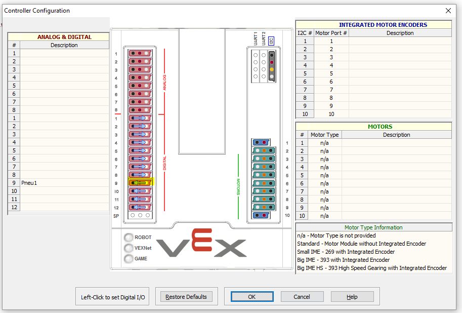

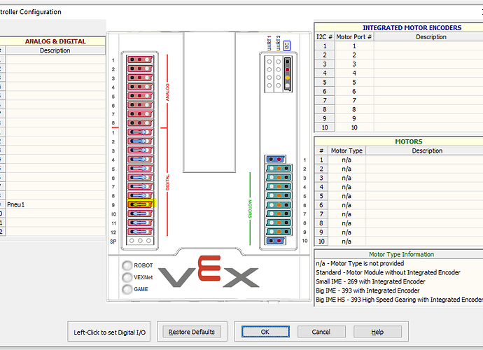

Open the Controller Configuration (F5) and identify the digital port that you want to use for your output. By default 9 through 12 are outputs but you can switch whether a port is an input or output by flipping the blue arrow. (See pic 1)

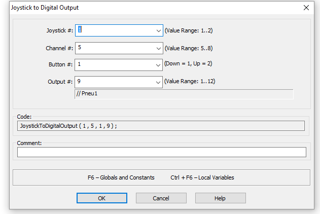

To test you can use a Joystick to Digital function. Select the button in the wizard and set the output to the digital output you plugged into (See pic 2)
