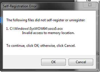

I’m trying to install easyC v2.9.3.5 on a Windows 7 64-bit computer. When I do, this error message pops up:
[ATTACH]3727[/ATTACH]
How can I fix this?

Make sure you have DEP(Data Execution Prevention) Set To “Turn on for essential Windows programs and services only”
If it’s off reboot and try again to install easyC. If that doesn’t work call customer support so we can take a look at your PC.
We installed it on a Vista computer instead… thanks for the help!
