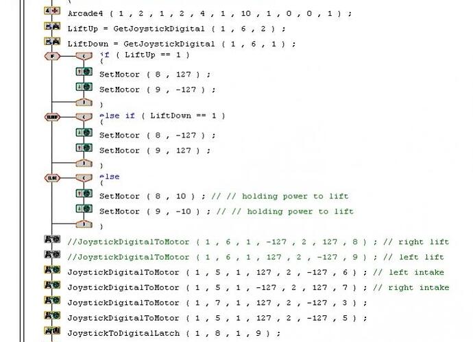

What I’d like to do is set a power of 10ish to my lift motors so they can hold their position without over heating. How can I do this? Thanks for the help ahead of time :smiley:

You are using these two lines of code to control the lift.
JoystickDigitalToMotor ( 1 , 6 , 1 , -127 , 2 , 127 , 8 ) ; // right lift
JoystickDigitalToMotor ( 1 , 6 , 1 , 127 , 2 , -127 , 9 ) ; // left lift
Button 6 up and down.
This gets replaced with several blocks that do the same thing except sending a power of 10 (and -10 for the other motor) to the motor when no buttons are pressed. You need to define a couple of variables to hold the state of the up and down buttons and then the code looks like this.

Hopefully I have the same directional control on the buttons (ie. I may have reversed positive and negative values to the motors).
same thing in block mode
[ATTACH]8075[/ATTACH]
