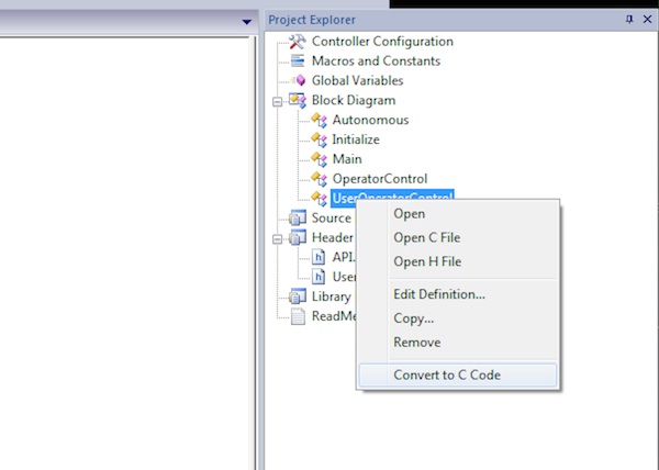

  1. Turn this function into a C file, right clock on the function in the project explorer window, select “Convert to C code”. This will be a one way process, once done there’s no going back to the flowchart mode for this function.
[ATTACH]8461[/ATTACH]

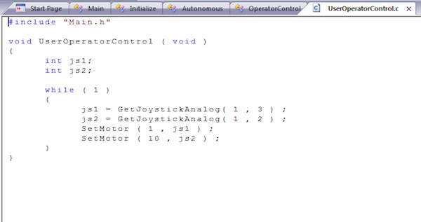

6 The converted file looks like this, a text file where we can now start programming using the keyboard rather than drag and drop.
[ATTACH]8462[/ATTACH]
