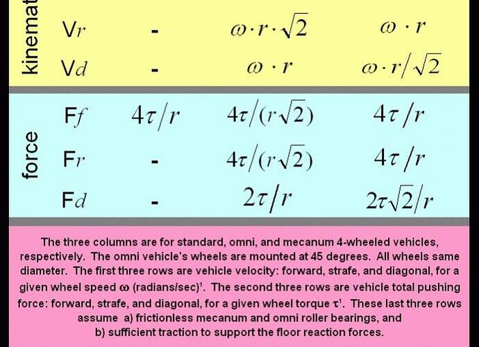

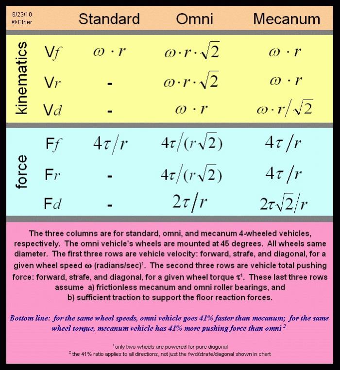

Many other roboticists have though about this issue. Some of there thoughts and analysis are here.
http://www.chiefdelphi.com/media/papers/2390
One chart that caught my eye was this.
[ATTACH]7577[/ATTACH]
The test Ephemeral_Being did was standard vs mecanum going forward, the first row of the chart. (omni in the chart means omni wheels at 45 deg).
