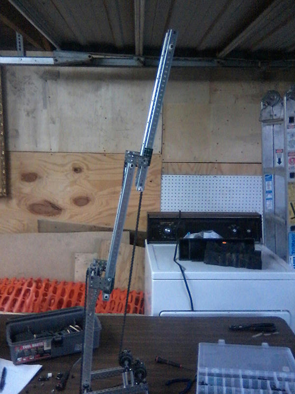

Here are some pics.

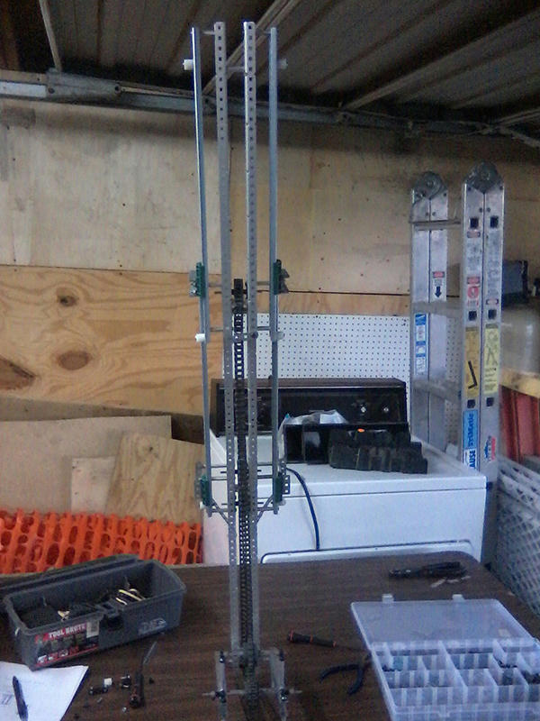

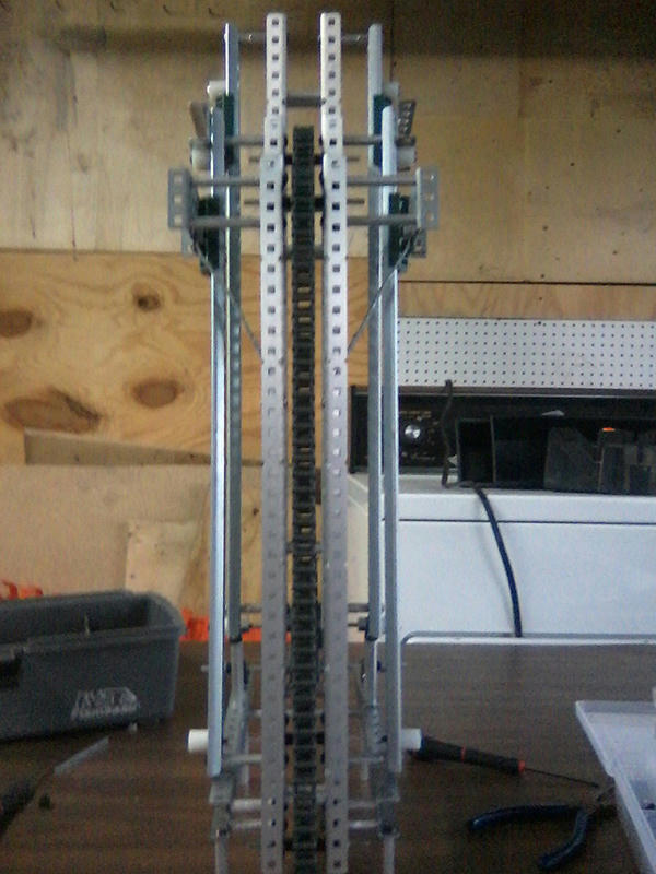

Here are some more…

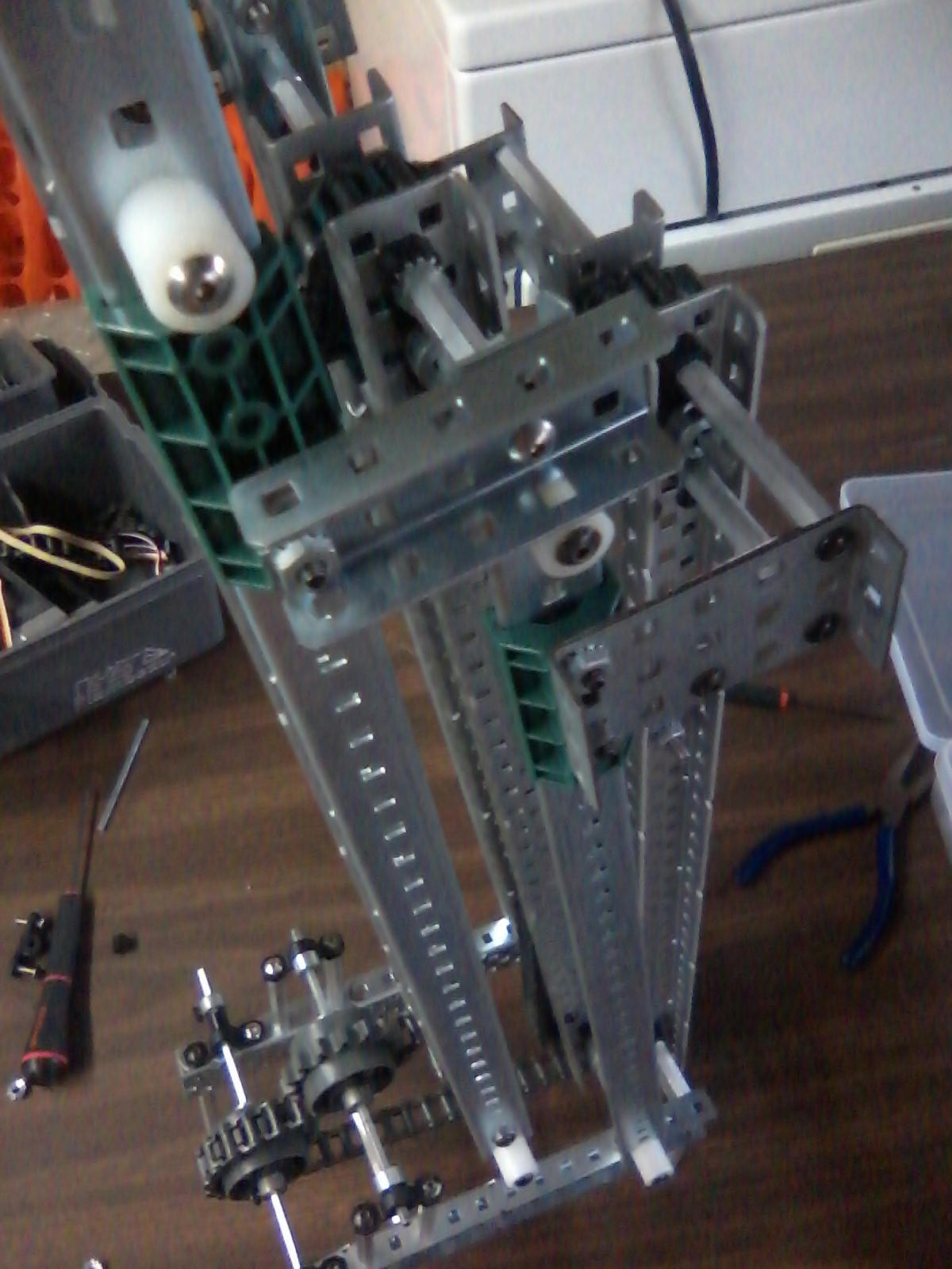

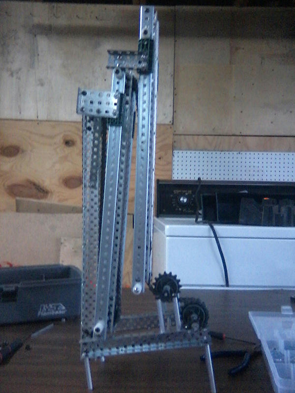

Annnnnddd one more…
Most of the leaning is due to the unstable base I just threw together really quick to keep the sprockets off the ground. However it does still lean a bit
Don’t use a single plastic slide per stage. Use the outer and inner slides in pairs, the way they’re meant to be used.
A lot of the lean looks like it is coming from the continuous chain pulling down on the top section. Either decrease the space between stages to put the downward chain closer to the base tier, or change the lift type from continuous to cascade (or even just change the way the chain is run through the lift)

Number of issues with this design
You start with your stage one, fixed section at an angle. Looks like you were probably trying to compensate for the lift leaning forward from the start, but this isn’t the (best) way to fix it.
The support that stage 2 slides in (top of first stage) needs to be square, it looks like it is causing stage 2 to lean forwards. Using the 2 inch standoffs isn’t helping, there’s going to be a lot of stress on that piece and it needs some substantial structure to hold it in the correct geometry.
Same problem on the stage 2 slider support.
Using a single slide truck is only supporting the slide over 2 inches. Use the technique JoeG recommends to double them up in the way I did.
Try and make the lift more compact. shorten the standoffs, have less distance between the slides and the chain.
One other major issue for the finally design, you are way over 18 inches.
I would also recommend placing all of the chain pulling gears on the bottom as close to the structure as possible, if the chain does not pull straight it can cause a huge lean like that, try getting the chain as straight as possible and it should induce a straighter lift.
