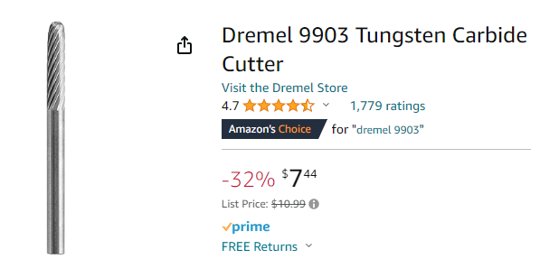

drill? (20 characters)
Hand file would be more precise.
This also works, BUT you have to be really careful. And do NOT operate indoors. It’s going to make millions of microscopic aluminum needles. They are small enough to almost float in the air (you could breathe them in, so operate next to the INTAKE of a fan blowing away from you. It’s also got a bad habit of ‘grabbing’ and running across the soft aluminum.
So, yeah, buy a hand file. You could probably get a chainsaw file from a local chainsaw shop.

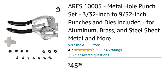

maybe this if you have a lot to do
