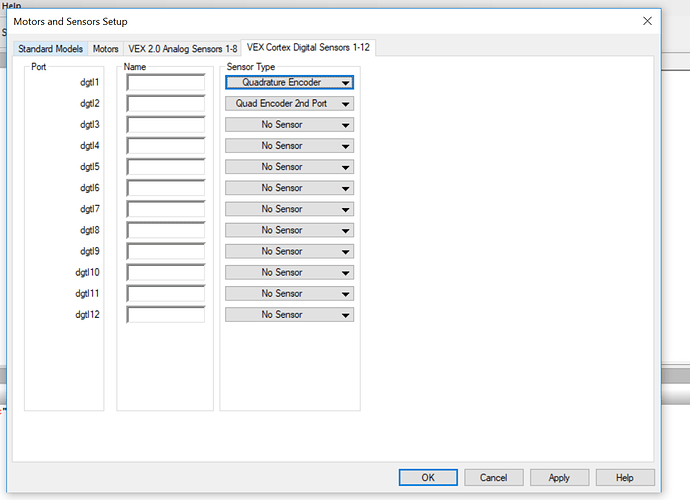

HI! Our team is using the encoders for the first time on our robot. Can anyone tell us where the two wires should be plugged in in the cortex? Pictures would be great!
2 adjacent ports in the digital ports.
Code you need to know: resetSensor(sensorName);
sensorValue[sensorName];
