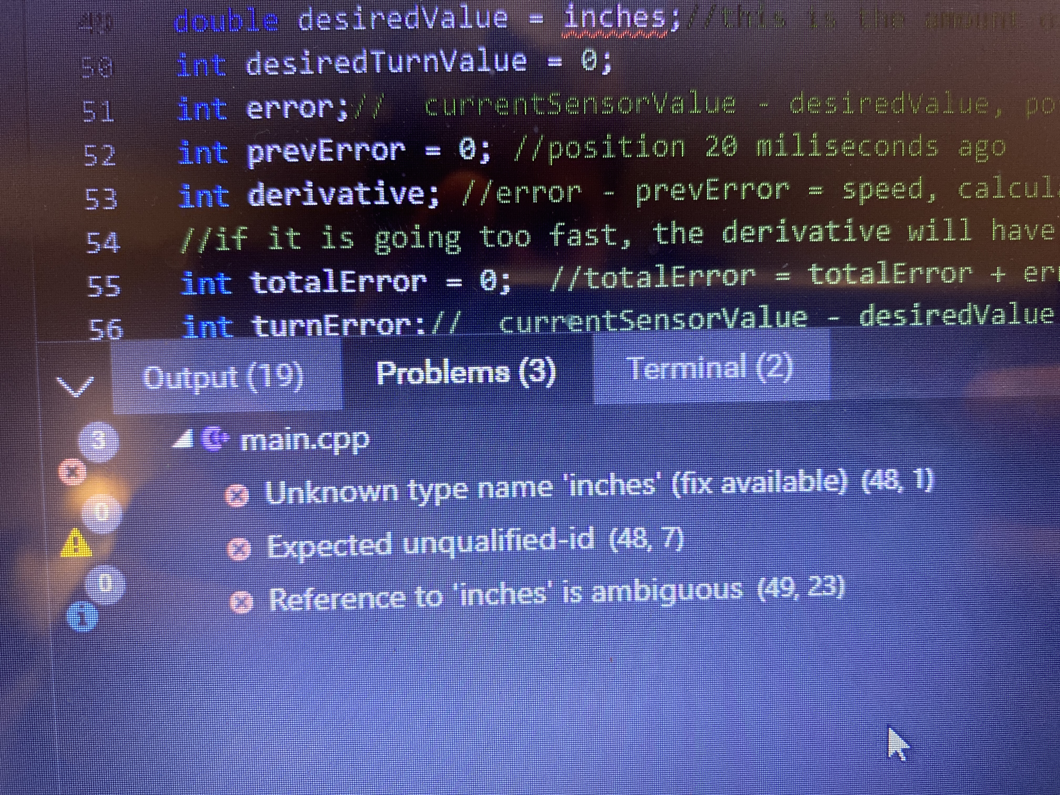

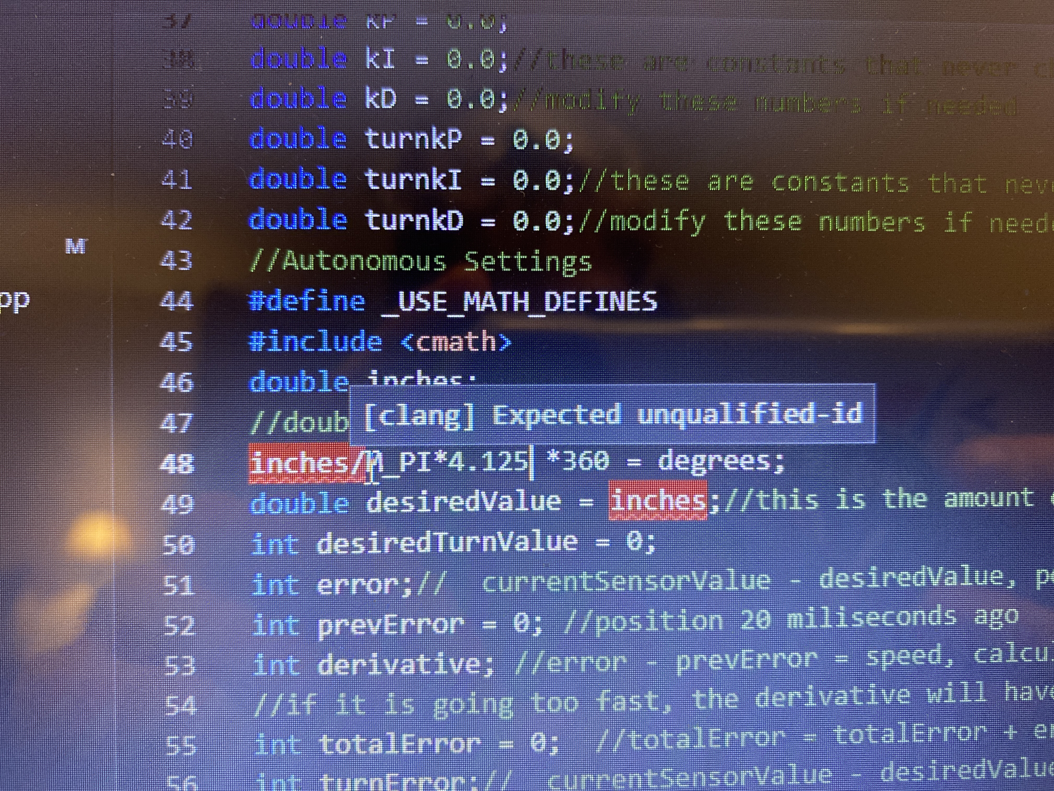

Ok, That makes sense. This is what I changed it to
//Autonomous Settings
#define _USE_MATH_DEFINES
#include
double inches;
inches/(M_PI*4.125) *360 = degrees;
double desiredValue = inches;//this is the amount of degrees that you desire – change if needed
Thanks! This helped alot!
#include
double inches;
(formatted)

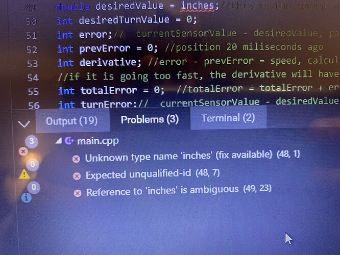

So I just put this into code and it gives me errors for the double inches
My thoughts are changing the equation so that the inches is on the opposite side of the equal sign but idk how to do that.
Ok so I went back to using the PID with just using degrees instead but my code isn’t working, I uploaded it to the robot and the robot does nothing. I don’t know what to do to fix it so that I can get it to move? I don’t fully understand PID and I don’t know what to change in the code. This is my code:

You declare inches as a double with no value, then you say inches / PI other stuff = degrees
It does not know what inches is, you need to give a variable a number before using it in most cases.
Could you explain what you are trying to accomplish with double inches, degrees, and desiredValue?
I tried to create a math problem for the computer to solve so that I could input a random amount of inches and that it would input it to the equation and determine how many degrees it needs to spin. The double inches is as a value so that I can input it as any number and it would solve the equation, Degrees is how many degrees the motors needs to spin and desiredValue is the value I want in inches. I didnt assign inches a value because I wanted to input it later in the code so that in my auton I could just change the value to be the amount of inches I want.
Ok just put degrees first then like degrees = stuff ;
Also P is Proportional not Potential

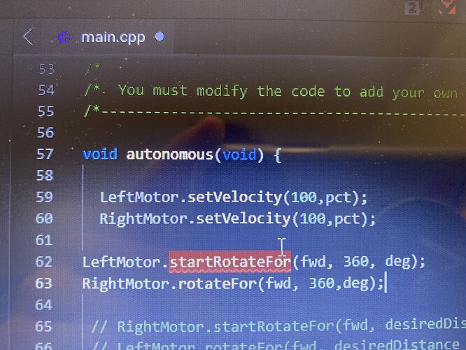

Hey so I’m trying to use the rotateFor and startRotateFor commands but the startRotateFor command doesn’t seem to work. I don’t know why, it just highlights it in red.
So it looks like you are only providing 2 values to a function with 3 parameters. You can check a list of useful functions here
void startRotateFor( directionType dir, double rotation, rotationUnits units, double velocity, velocityUnits units_v )
You are saying void startRotateFor( fwd, 360, deg ) the computer doesnt know the velocity units, or voltage units that you want.
LMK if this helped
Ok so I did add the velocity units but it still is highlighted red.
LeftMotor.startRotateFor(fwd, 360, deg, 100, velocityUnits::pct);
RightMotor(fwd, 360, deg, 100, velocityUnits::pct);
This is my code but the startRotateFor is still highlighted red.
What is the error? 20 char
The error said “No member named ‘startRotateFor’ in ‘vex::motor_group’ (61,13)
I understand the problem because I was using a motor group in vexcode pro but that command only works for individual motors! Thanks for your help though!! Really appreciate it!
