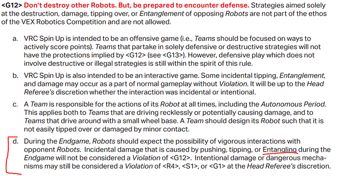

I would disagree. It says incidental damage will not be considered a violation, but dangerous mechanisms still may be.

Yes. There is a stipulation in <G12> that “Intentional damage or dangerous mechanisms may still be considered a Violation of <R4>”. Remember that <G12> only legalizes incidental damage during the endgame. String cannons may or may not be considered an unnecessary risk of entanglement, dangerous mechanisms, or incidental damage. There is a risk.
Incidental is referring to if your playing the endgame, which a string cannon would be playing the endgame and that got entangled with another bot, then no ruling would be made as it was incidental. Incidental is there so I don’t just deploy a mechanism who’s sole reason is to entangle with you.

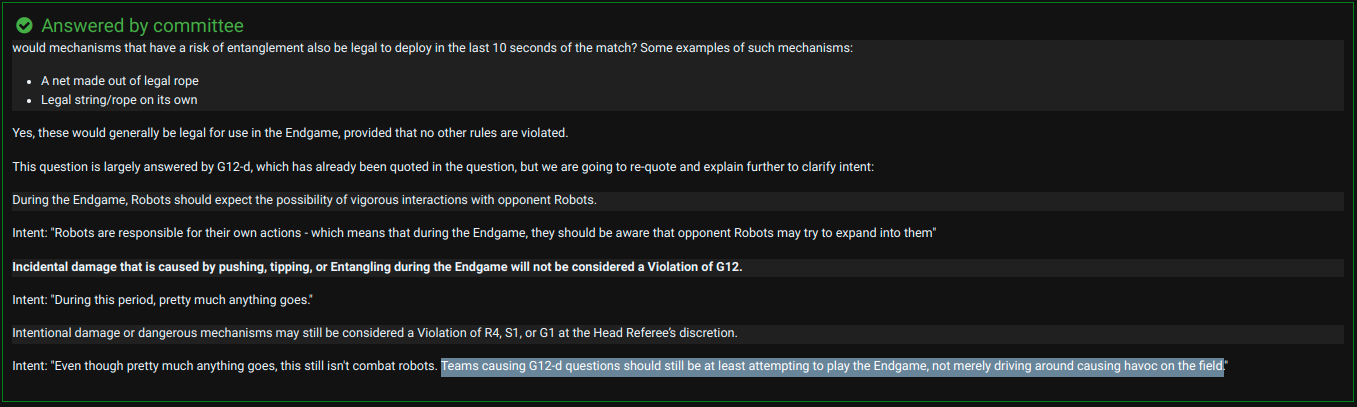

String launchers are legal!
Intent: “During this period, pretty much anything goes.”
https://www.robotevents.com/VRC/2022-2023/QA/1110

Aren’t string cannons dangerous mechanisms? I know that within the confines of the endgame period, entanglement and trapping don’t exist, so they would be legal during the endgame, but I don’t really see how a string cannon would pass inspection.
The Q&A only talks about how it’s legal in the endgame, yet mentions nothing about the actual inspection, where its stated “dangerous mechanisms may still be considered a violation of R4 at the Head Referee’s discretion”
I guess it would be a per competition thing, where depending on how the head referee sees it, a decision would be made, but I’d like to see some clarification on what a head ref should say, if they should allow a string cannon or not
Well, my logic says that for a mechanism to be legal for the endgame for any practical purpose, it has to pass inspection. So if the GDC says string cannons are legal to use in the endgame, it doesn’t make sense to say they can’t pass inspection because of a rule that was mostly nullified for the endgame period.

The vertical expansion limit persists in endgame. Any “canon” would have to keep its projectile below 18"… which makes it (relatively) safe for all but the shins of drive team members and refs.
That said, if the launch mechanism sent out a weight with force that trailed string, I would scrutinize it closely in inspection. At some point common sense will apply – if the force is great enough to potentially cause greater than incidental damage it could fail inspection. (Something I expect to get covered in Q&A once we see match play and some of the endgame solutions in action.)
