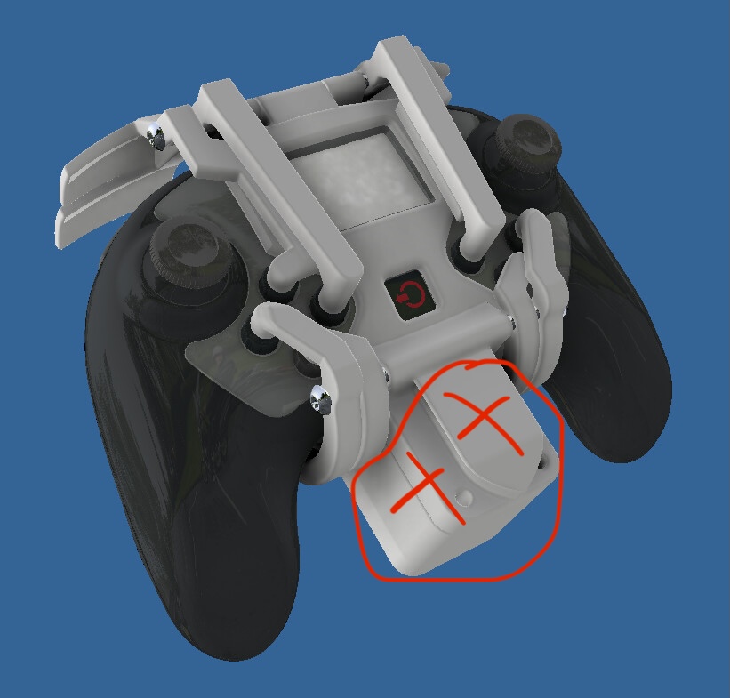

Thank you! I’m new to CAD so I was wondering if I can edit the structure of the files (.obj)? We printed this before but the structure for the front grills was very weak so I wanted to beef them up and also remove the whole usb-c extension thing on the bottom.

What do you mean by front grills, and do you want me to just cover up the usb holes?
Thank you so much for helping! I attached images below of what I wanted to modify on this controller mod. The front grills I circled. I also wanted to remove the entire bottom portion to allow for more space / direct charging to controller using the native micro-usb port.
Sorry for the delay, I’ve been able to remove the big USB thing on the bottom, but since it’s an obj file it’s quite difficult to edit, and the usual obj or gbl to step file converters resulted in onshape struggling to import the parts. I’ve resorted to using tinkercad, which for some reason processes the files better than onshape and solidworks, so it might take some time.

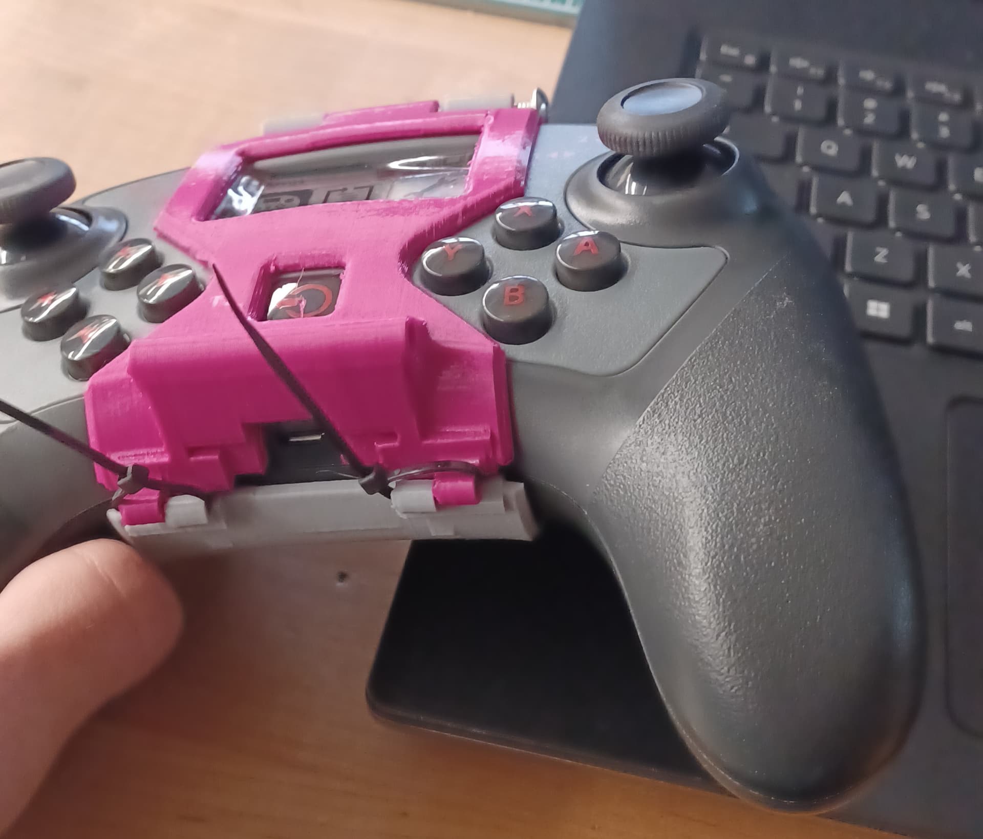

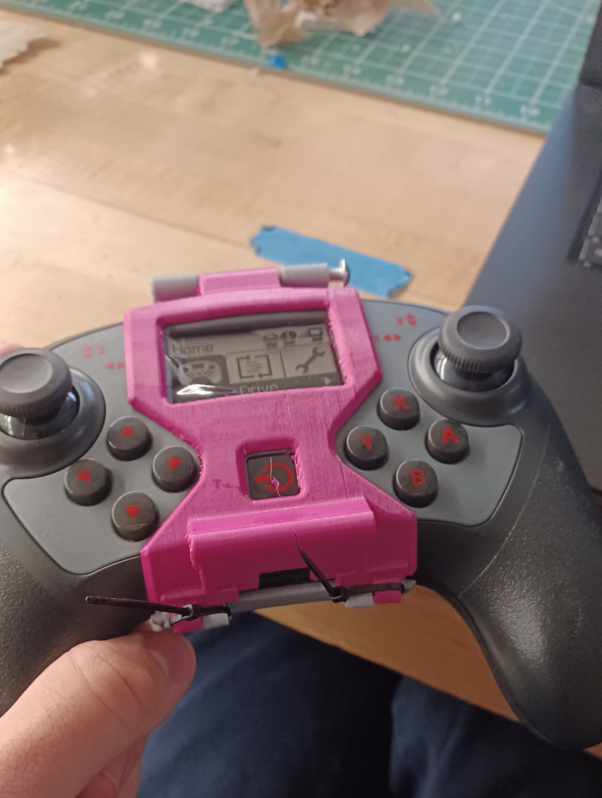

So far have made some good progress. It’s quite a tight fit (gave my wrists a good workout), still haven’t tested out how the paddles fit (ignore the chipped paddle mount in the second image, I had my supports configured too close to the print).
Used the other scuff mod CAD files to recreate some missing geometry, hence the weird fit.
Here’s the CAD file in case you want to test it (though it may not work) : Onshape
The only things that are edited are the upper and lower clamshells, everything else that hasn’t been modified is under the “non-modified” folder.
