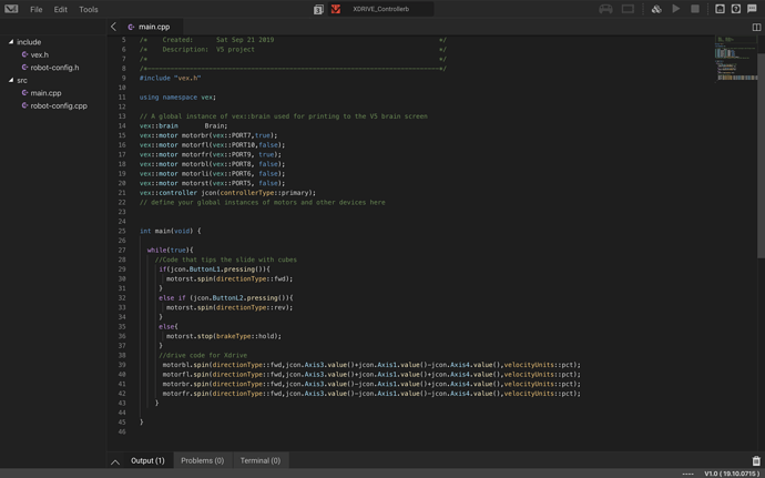

Im trying to upload code, and it wont upload code. it says “[error]: make process closed with exit code : 2” any Ideas?
Most likely a missing } or ;
Check the line right before that in the console, should give the code line location.
We’re gonna need to see more about it. Could you post the entire error?

And here is the error
unix build for platform vexv5
CXX src/main.cpp
LINK build/XDRIVE_Controllerb.elf
build/src/robot-config.o:(.bss.Brain+0x0): multiple definition of `Brain’
build/src/main.o:(.bss.Brain+0x0): first defined here
make: *** [build/XDRIVE_Controllerb.elf] Error 1

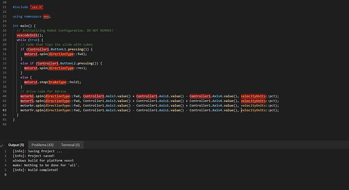

Your code compiled for me. Only change I made was “int main(){” You did not put “i”
Unsure if you did not copy the “i” when you created this thread or you forgot to put the i in your function.
it says “int” on mine. Im not really sure what’s going wrong

You defined everything outside of main correct?
Yes, all defined out of main
Missed something: try putting your definitions in main.cpp if they aren’t. That multiple definitions error can occur when you don’t correctly define variables/objects in a separate file and the one they are referenced in. I’ve had that issue before I learned how CPP actually works
